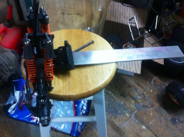

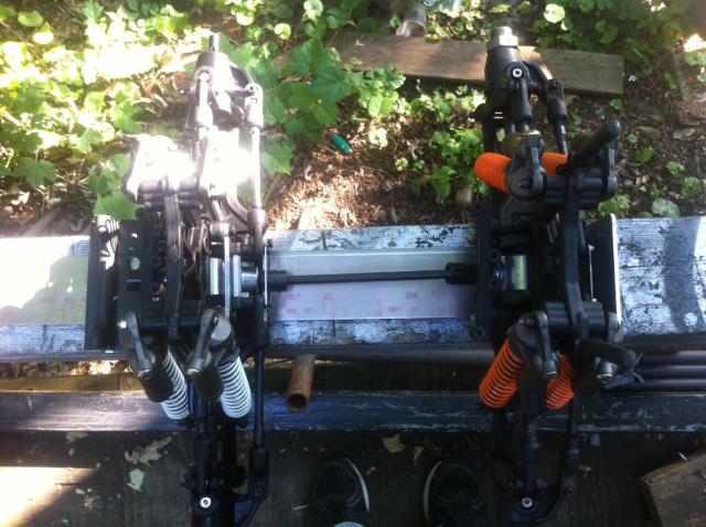

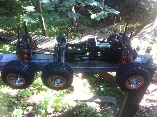

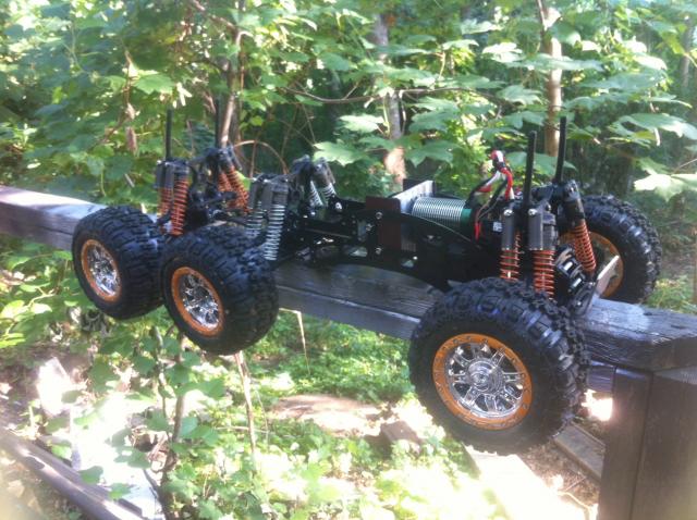

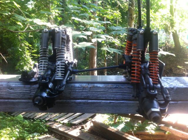

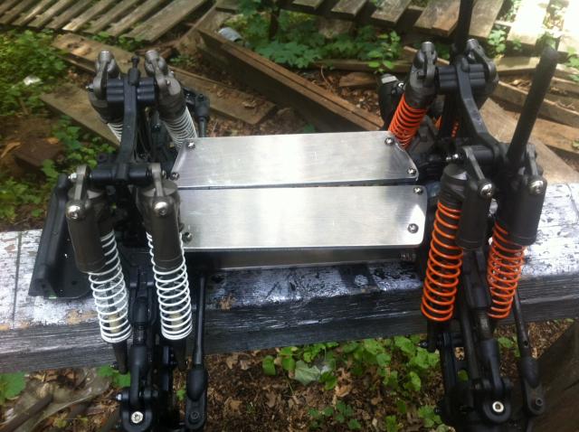

Well I had a hard time keeping the front end down so instead of a wheelie bar I added a second set of rear tires
More pics to come.

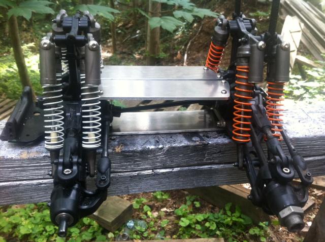

some more

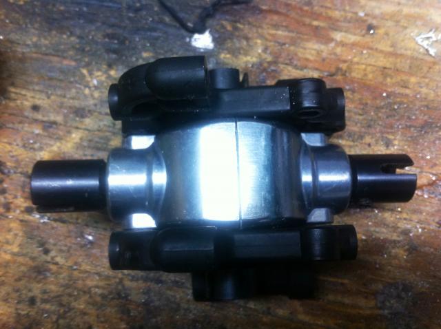

Wowzer!! Very interesting!! How did you fab up the middle diff case?

The Nemesis diff cases are aluminum and split right down the middle just use 2 pinion sides and a little grinding on the case to make it all line up. The chassis extensions are made out of 4mm 7076 T6 aluminum Still have to build the top brace. Wheel base is 24"

Is that the natural split in the case of did you have to cut it in the middle? I'm not familiar with the Nemisis specifics.

They come split just use 2 cases to make one.
