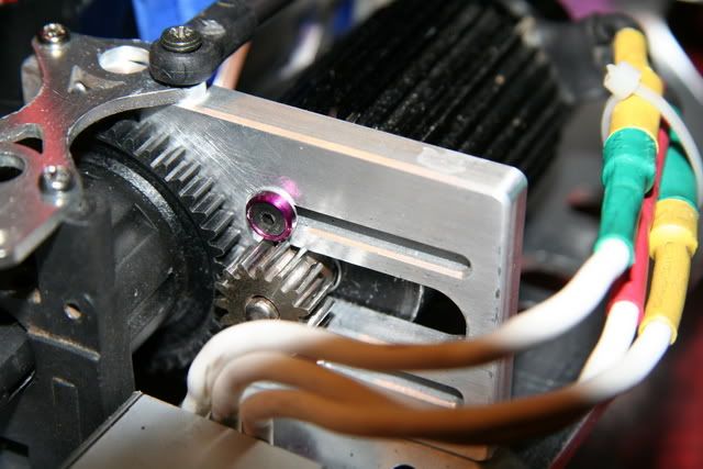

Hello:
this first one is my project.can aid, suggestions. specifications:
XB8 MAMBA MAX
FEIGAO 540C 8XL
2 LIPO MAXAMPS 6000MAH 20C
IT CROWNS 46T-PLASTIC HELL PINION MOD1- (HELP)
I have used an old chassis of asso for the first support of lipo, and the cover of the servo one. The motor where I place it better? upon the differential? that motor mount of mike can to be worth to me? bearing of the differential (8mm*16mm*5mm) thanks and suggestions. pardon by my English of google.

If you are just going to put the batteries on one side, it's best to position the motor on the other side, like in your first link. The second link is one you'd use for a dual battery setup.
If your batteries are quite short, you can also put the motor on the other side of the servo and one battery pack on each side still.

hello BRianG: setup is of 2 lipos 7.4v 6000mah 20c of maxamps. one to each side. then the motor arrives. thanks Bryan. it will ask mike
