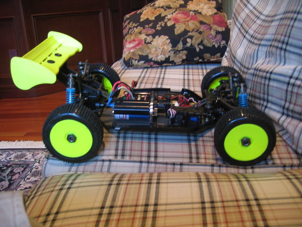

You guys have any tips on how to mount two 6 cell GP 3300's? The only fit on the mud gaurds sideways. Here's the final pics:

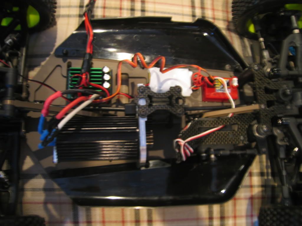

Throw the MM and UBEC on the right side (on the mud guard if you have to), and then you'll have more room on the chassis. This will allow for better handling, since the ultimate handling would occur with everything lined up as close to the center of the chassis as possible. Here's my Hyper 8 for reference:
http://img.photobucket.com/albums/v1...o/IMG_5551.jpg
Any variation of that will work, of course.
