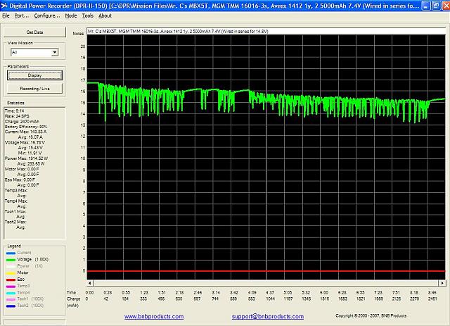

could you zoom in at a few high amp peaks so we can see the voltage drop better. thanks

nielis,
Here is just the voltage curve.

these cells are very good, around 3,6v @100 amps.
is the price in the flightpower range or lower?

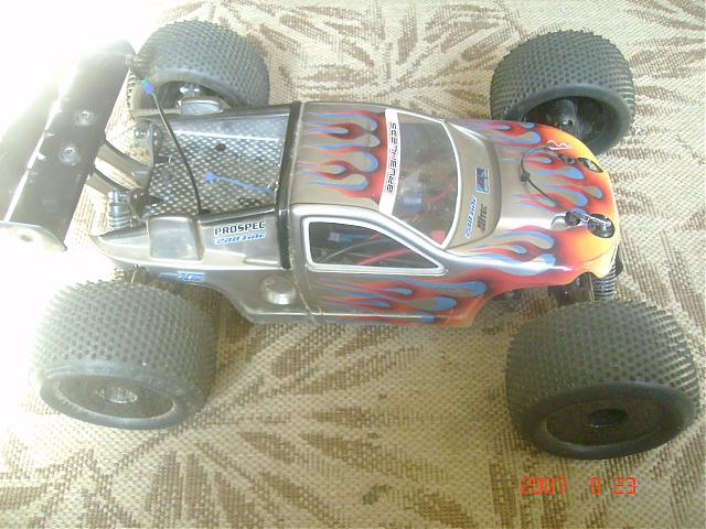

Some pictures of the MBX5T.
