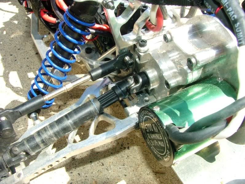

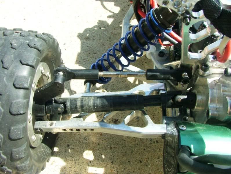

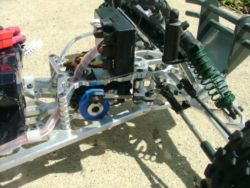

Here are some pics of how the 3s2p fits. Also the Jato driveshafts are holding up nicely. Just need to shrink some heatshrink and add the Park BEC.

Hey, nice servo-saver. Is it any better than the stock? Care to divulge where it was purchased?

it's a shaved down dynamite servo saver. Works good for me and I'll purchase another one soon for my next build up. Was like 7 bucks at my LHS.

i just picked up the same one for my emaxx last week. probably the same hobby shop. i asked for a kimbrough(sp), but they didn't have any and he said that one was better because of the metal insert in the center. i got it and so far its holding up. the spring is softer than my last kimbrough saver i had, so time will tell if this can hold up to my weight. i'm sure in you truck its a perfect match.
