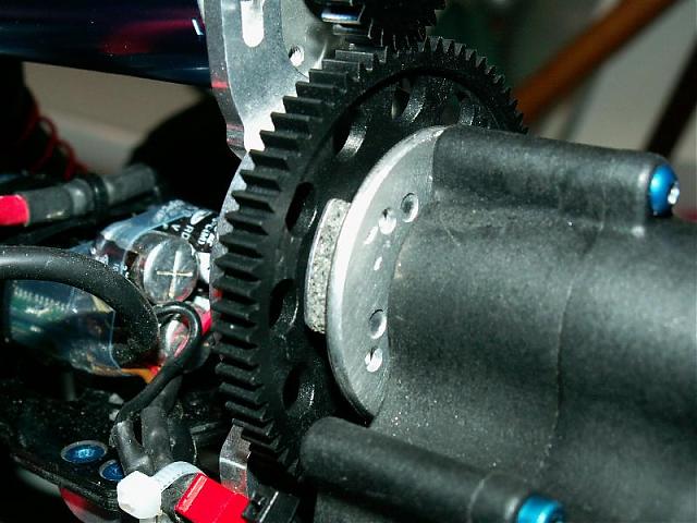

decided to make my own slipper with the new t-maxx upgrade kit (5351X) since I was hoping they where going to release the same kit for the e-maxx but not sure if they will and didn't want to wait. Only thing I had to do was drill a hole for the slipper pin at the correct location and I removed the cooling fins on the slipper (didn't have a choise as i'm using a gorillamaxx mount and didn't have much room to play with) Other than that I put some spacers so I could use my e-maxx input gear shaft and it works like a charm. Now I can finally run some slip without melting anything... and can have all the replacement pads I need. youhou... take a look at the pics. Sorry I didn't take any while building it and dont want to take it off again. lol
