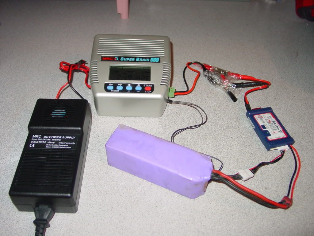

I also use the 989 and that same battery (TrueRC 8000mAH 4s pack). However, I use the Hyperion LBA10 balancer, and I always balance while charging. 16 volts is fine.... at the end of the charge, the battery should be 16.8V. Here is how mine is hooked up if it helps at all:

No lipo sack???? Serran wrap???? I'm amazed you havn't blown up your house like that!!!
hahahahahaha lol ;) just kidding
jnev
jnev's Avatar
Posts: 2,864
01.06.2008, 01:27 AM
It is working great for me. I charge it right where it is in the picture, which was on the work bench. So far, nothing has gone wrong (knock on wood).
