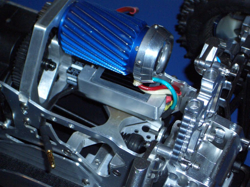

I use M3, M4 taps, scroll saw, rasps (different grades), dremel, drills, scotch brite/waterproof sanding paper, calipers, ruler and some patience.
Easiest thing to do is to draw something, and print it 1:1; that way you can simple put the 'template' on the aluminum with double sided tape and cut away the stuff that's in the way.
A vice is a handy tool too. As is a press drill, but you can manage without both.
you are able to make parts like this fair easy;

BlackedOutREVO
02.09.2008, 02:52 AM
Thats just showing off Serum
Thats amassing!

Serum
Serum's Avatar
Posts: 10,480
02.09.2008, 02:57 AM
NO man.. that wasn't my intention.. Just consider what you can make without too expensive tools
That's not showing off, i don't consider myself good at it. Considering the used tools, it's okay though,
this was 10mm thick aluminum, a lot harder to work on. made the x-brace and the holder for the schulze the same way.
Seems like we both make our parts very similarly (print out drawing and double-sided tape it to the material, cut with scroll saw). Except you definitely take more time on yours, getting the edges nicer. I don't finish my parts like that...
You didn't cut that CF with the scroll saw, did you? I haven't had a blade last more than 30sec. on any composite fiber materials (fiberglass, CF, G10, etc).
Serum
Serum's Avatar
Posts: 10,480
02.10.2008, 03:20 AM
No, i cut that carbon with a cutting wheel and the dremel.
