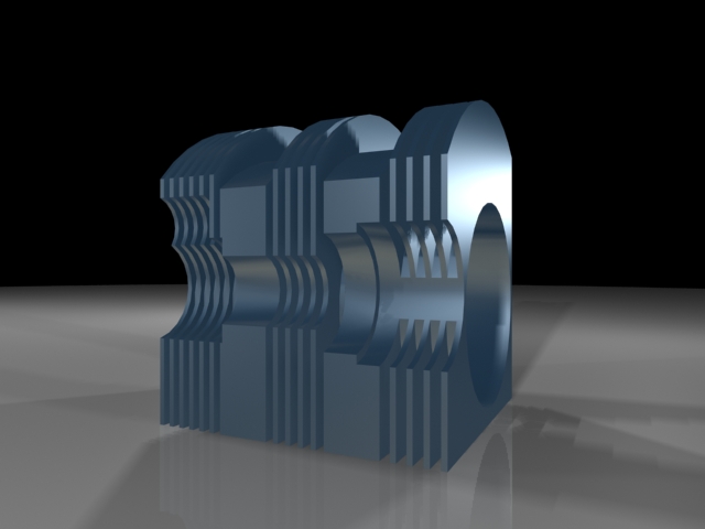

I haven't made much progress on the project, I have only just received my speed control back from MGM after having the latest firmware installed.
Attached are a couple of 3D drawings of my motor mount I want to have machined up. There are a couple of minor details missing from the drawings but they are the first drawings before revision.
Cheers Andrew
