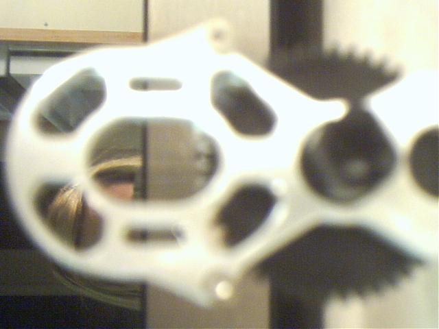

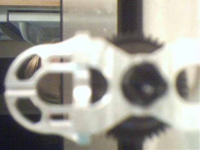

rc-monster center diff/motor mount for flm e-maxx chassis, sorry for the crappy pics
WOW thats friken sweet!
Neil is right on everything :)
The chassis was cut with a jigsaw/file and a DA.
