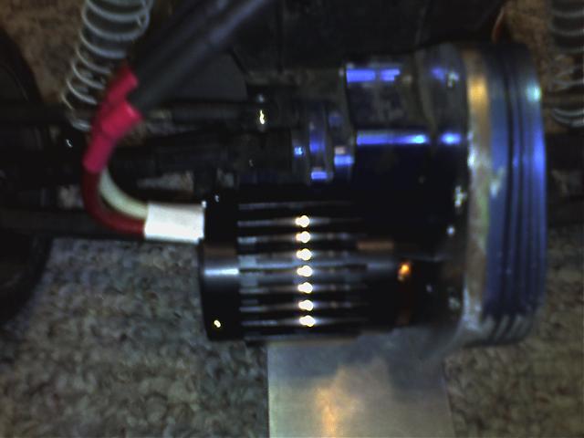

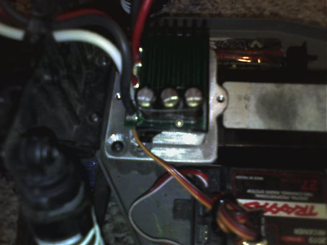

speed demon
Posts: 123
Join Date: Mar 2008
05.02.2008, 01:50 PM
Got the MM today and hooked it all up. Was impressed how easy it was and how good it works; no cogging or anything else. Here are a couple pics. I'm still trying to figure out what fan and what connectors I need to plug into the receiver pack for power. Any suggestions?

05.02.2008, 05:48 PM
I got my first run in and I'm not happy with it. The temps on the motor were131 max but the controller was 219 and it shut down on me twice. Also top speed with same gears, lipo, ect... was alot slower. Am I programing it wrong? What is a good setup on the controller? Also the lipo was the same temp. as normal.
  (#57)
DrKnow65
DrKnow65's Avatar
Posts: 998
Location: Colorado
05.02.2008, 07:08 PM
what speed is it geared to? You may need to gear up some. I would think that ~40mph should be close for a starting point. Remember that 6 pole motor makes tons of torque so tall gears will not make it unhappy. The esc will be switching overtime with small pinions causing it to heat up.

  (#59)
speed demon
Posts: 123
Join Date: Mar 2008
05.02.2008, 07:37 PM
OK I have a 28pin which I will try. I was just baffled because both motors are 3500kv. I figured that they would have the same top speed with everything else being equal. Where did I go wrong with that thinking? One last note the new motor draws more power then before. During our ten minute races I usually pull 2800mah but this time it pulled 3600mah.
  (#60)
DrKnow65
DrKnow65's Avatar
Posts: 998
Location: Colorado
05.02.2008, 09:24 PM
Heat is produced by waised wattage. In other words your MM was acting like a 300watt heater and an ESC :(
The difference in the two motors is the pole count. The 2 pole motors don't produce as much torque but they spool up well and have good high end power. The 6 pole motors make tons of torque and bottom end power but the get less efficient at higher RPM's.
Lots of gear should bring the rustler around.
What settings were you running on the MM? I'm guessing by the sound of the lack of top end speed you are at full throttle and max rpm alot?
The teps should be fairly even for the ESC, Batt, and Motor. With the motor being a little warmer than the rest. Seems like 140*f is the max acceptable for all the components.
