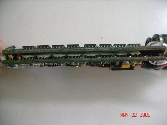

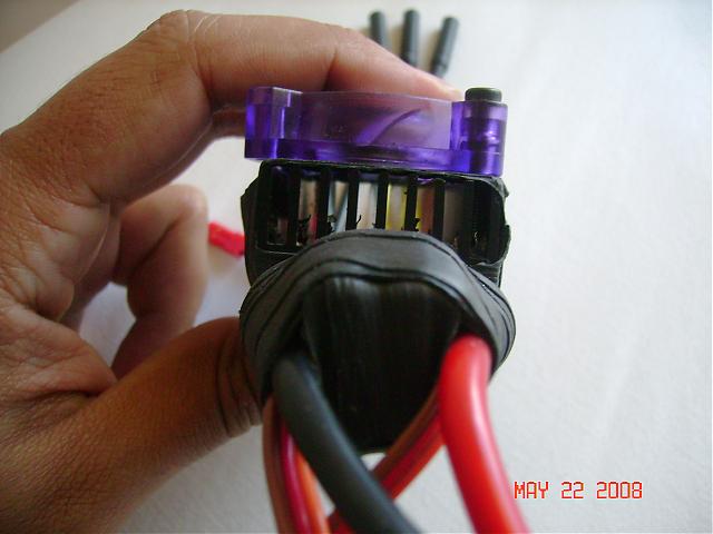

Some pictures.
ID:	4658   Click image for larger version

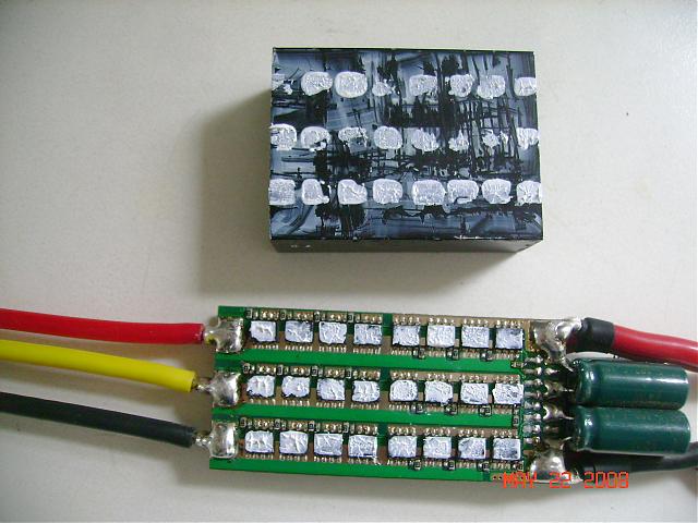

  (#49)
lutach
lutach's Avatar
Posts: 5,139
05.22.2008, 01:44 PM
Some more.

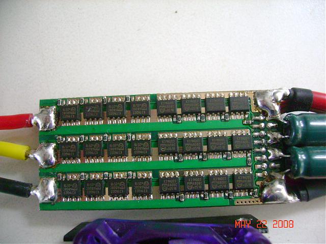

  (#50)
lutach
lutach's Avatar
Posts: 5,139

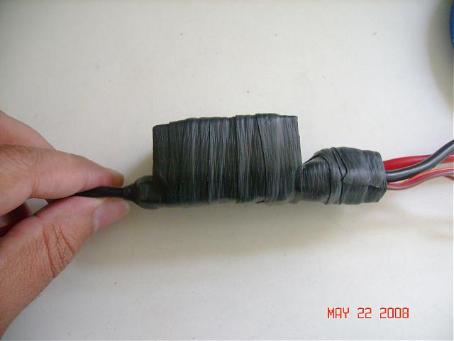

And more.

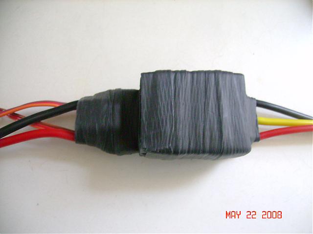

  (#52)
lutach
lutach's Avatar
Posts: 5,139
05.22.2008, 01:51 PM

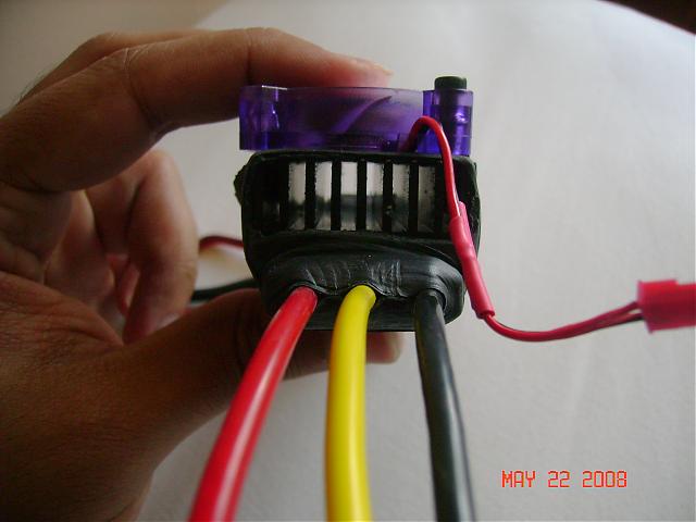

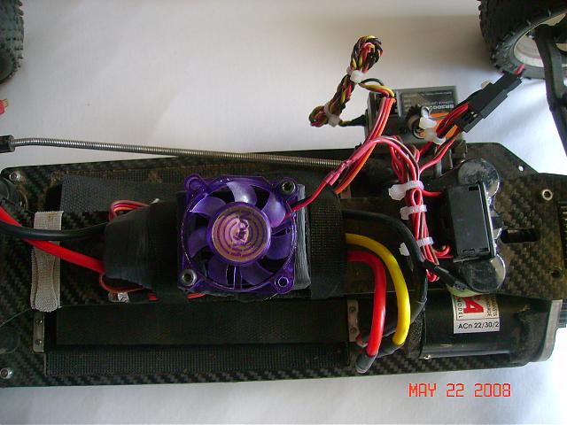

Now let me explain the ugliness. I was going to use shrink wrap, but most of the controllers I have with shrink wrap seems to make it shrink some more. So I had some of that Self Fusing Silicone Rubber tape here and decided to try it out. One advantage is that it will withstand higher heat and it should harden a bit in a few hours. You can also see that it makes for a much more water tight application. It also smells like my uncle's rubber factory . I will find my on/off switch and add it to the fan and use my rx pack that's already in the truck to run the fan. I don't need the rx as the BEC on this controller is just doing a great job and hasn't failed yet. Hope your guys enjoy my Frankenstein job .

  (#55)
lutach
lutach's Avatar
Posts: 5,139
05.22.2008, 05:22 PM

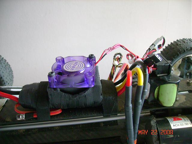

Got the controller mounted and fan working. Tomorrow I ill see how it does and hope fully it will stay cool.

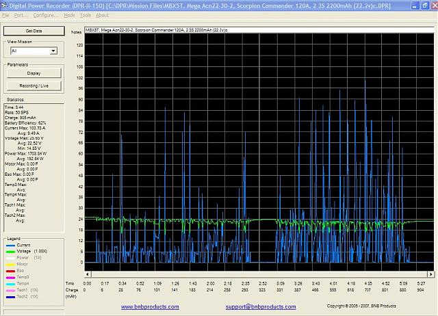

  (#56)
lutach
lutach's Avatar
Posts: 5,139
05.23.2008, 11:19 AM
Just came back from a quick run to see what was improved with the Heat Sink/Fan combo. I must admit, I've extremely impressed now. The controller performed very solid and didn't get hot at all. It was just warm and I guess the heat sink/fan made the difference. The Mega is getting a beating and it is just an awesome little motor. If Mega comes out with a sealed version of the ACn22 series, I'll be adding some to my collection.
