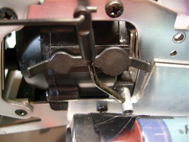

I have dual metal brakes and I can easily do a frontflip as it is.  I dont need more braking power at all. I have the stock steering servo. It may have helped a lot that I modded my brake lever like this.
