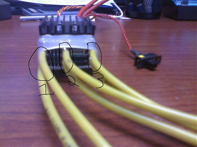

2 reds to battery +, 2 blacks to battery -, 2 each yellow wires (pairs on top of each other) to each motor plug. You are going to need 5.5 or 6.5 connectors to get all the wires in.
