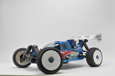

I just bought an LRP S8BX Buggy which is the same buggy as the SH buggy that metal man just converted. http://www.lrp.cc/en/products/rc-car...buggy/details/
I'm am now trying to see if I can get a motor mount that will fit this buggy. I measured the hole spacing on one of the centre diff mounts and it is 21mm from mounting hole centre to hole centre. Are there any other buggies with this same hole spacing that mike makes a motor mount for already?
I'm thinking I will use 4s in this buggy with a 1512. I'm not sure which 1512 to get yet. I'm thinking I'll get something that can handle 4-6s but better for 4s.
