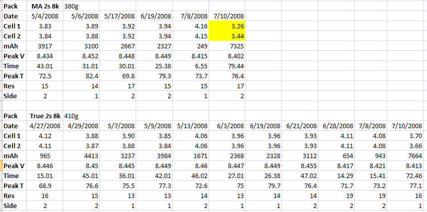

Here are the charging logs of each pack. Cell 1 and 2 are the voltages of each cell at the beginning of the charge. Side shows which side of the DUO the pack was charged on. Res is the resistance as indicated by the charger. Peak T is the peak temperature. If it's higher than 75F, it's likely because it was warm when the charge started.
Anyway, you can see with the MA pack that I never even used half the capacity before last night's run.

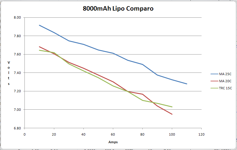

Here's the EagleTree data of the two packs, along with the 25C MA pack. This is when all three were new. I ran them in my Kyosho 1/8 scale buggy (MM/UBEC/8XL) around a "track" in my front yard for a timed 5 minutes each. I then averaged the volts recorded at each Amps unit. I did the best I could to make the runs as equal as possible and the count at each Amps unit was pretty even, so I think it's a fair comparison.
You can see why I said they are very close in performance when brand new. If anything the MA pack was a hair better, but I'm pretty sure it's not anymore. I'll have to test them individually again and see what happens.
