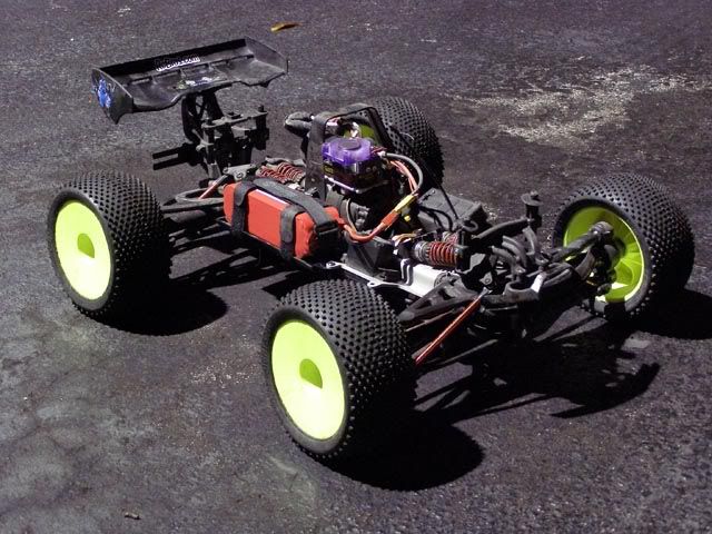

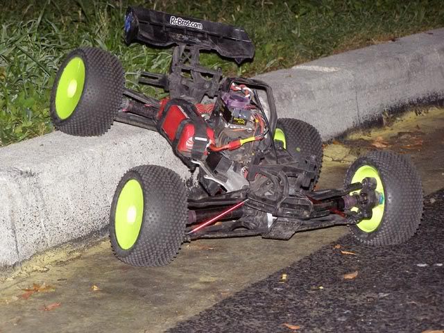

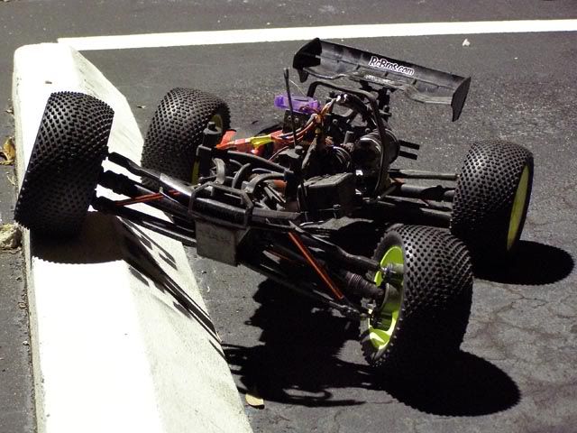

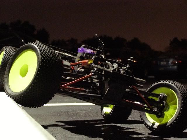

Blue the power delivery is about the same, the weight difference is noticeable in the handling.
Linc, it is in a converted revo, rc-m mount, tekno battery tray and esc mount, geared 17/38, 17mm adapters and crime fighter lpr's. Until I get my MMM back I am using an MM + ubec + fan. and JR ds8611a steering servo. 10.1 lbs with desert rat body on.
I also have a set of the LPR Crimefighters that I run in addition to the Maximzer Beadlock/Badland combo...what i like about the LPRs is they have the least amount of balloning of any combo I have run...the Badlands balloon a lot...
