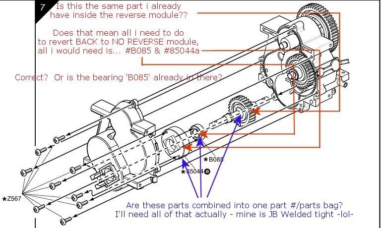

danhfvcsd
07.26.2008, 10:44 PM
ahhh thanks mate - now i see what you meant -lol- I was wondering what i was gonna replace it with... i'm kinda slow like that -lol-
Here's another pic that will make more sense than me trying to put it in words -lol-
So basically - all i need is the whole "Transmission Output Shaft Assembly" (my own name for it -lol- just the parts with the BLUE arrows) i think... and this replaces the reverse module, correct? =)

Looks to me like what you will need are the shaft, 86081, and part number 85044. You should already have the bearing and the gear in the trans, not in the reverse module, as it is. look at this page,
http://www.hpiracing.com/graphics/in...87032-1_p3.jpg
I don't believe either of the parts you would need are in the reverse module.
