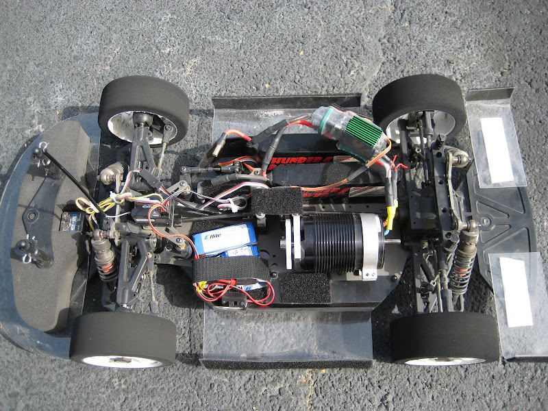

Wow, that thing is a monster. Great job fearandloathing. Its good to see you have a chance to do some bashing over in Iraq. My electronic setup is almost exactly like yours. I don't want to hi-jack your thread but I just want to compare setups. I am running a 2215/3Y in an OFNA ultra GTP (10 lbs ready to go) on 8s with a HV-110 and I have gotten it up to 83mph. I am going to try 12s soon. Your project has given me inspiration to push the envelope! Great design and have fun with the car! (click on the pictures for full rez)
This is a from the 83mph run with Eagle Tree eLogger V3 with 5hz GPS. I'm pulling about 2200 watts:
