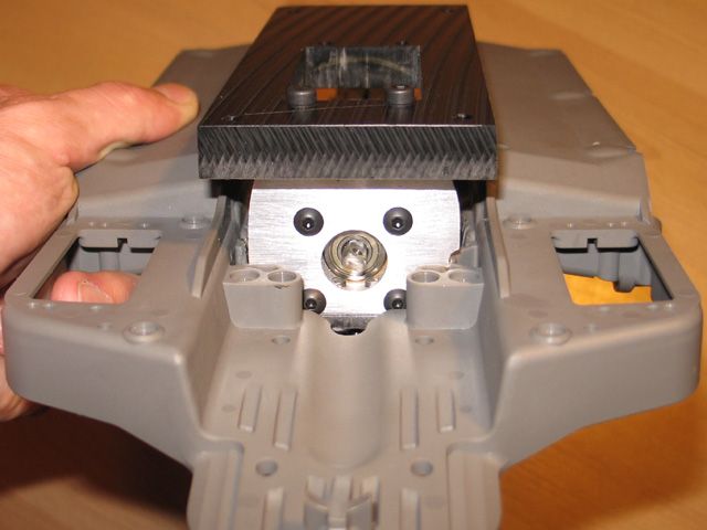

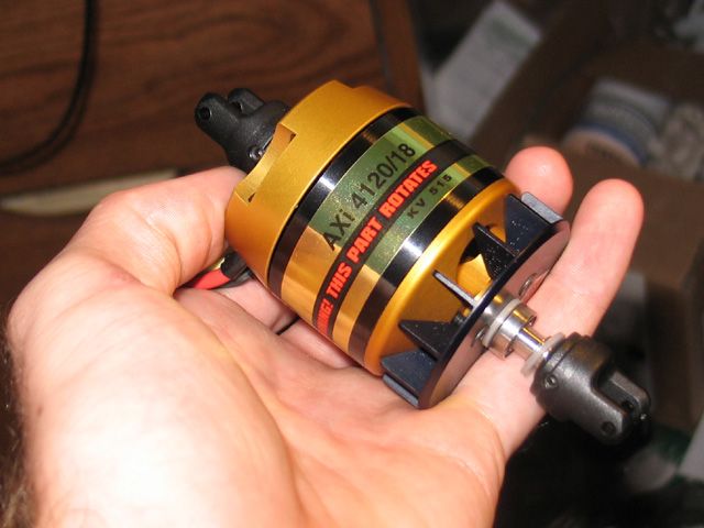

The motor required a custom shaft to work properly for this conversion:
The mounting-end of the motor will face the front of the E-Revo, and the other end will be supported by a couple bearings riding in another mounting plate.

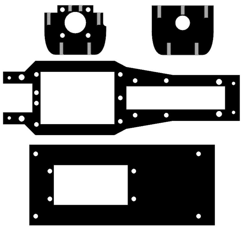

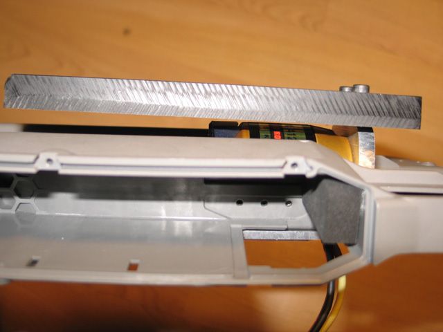

Got the drawings done, here is the pretty version:
Top left is the motor mount, top right is the rear motor brace, middle is the upper chassis brace (ties the front shock mount to the rear shock mount), and bottom is the skidplate. Also, the cutout shown on the skidplate won't actually be a cutout, but where a 1/4" deep pocket will be milled out. The skidplate will be 1/2" thick black delrin.

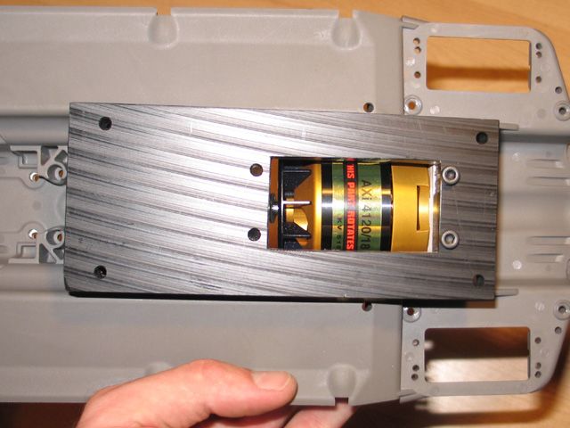

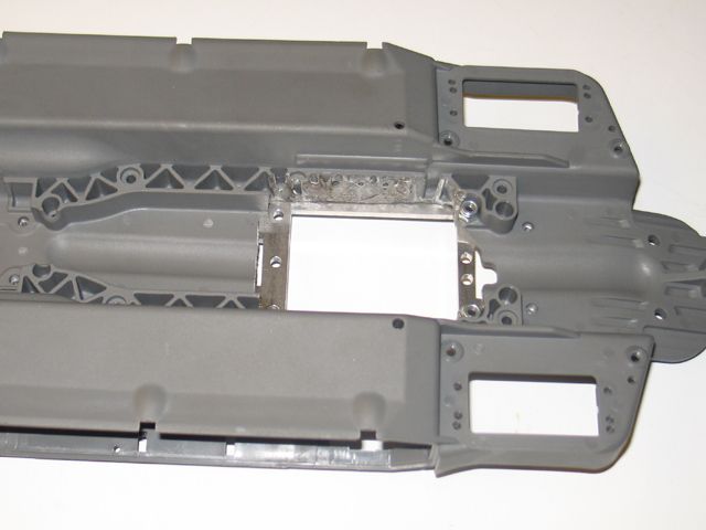

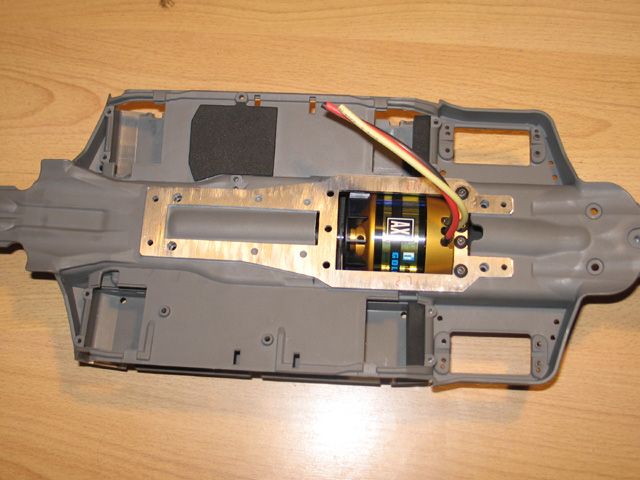

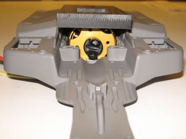

More pictures!
Obviously it's not done yet, but it's coming along.

More progress!
In the last pic you can see that I made somewhat of an error. To correct it I'll either cut out a lot of the delrin skid or the aluminum motor mount. But other than that, so far so good!

Nice custom work for the direct drive. You should save some weight without a tranny. You'll want to make sure that the bottom skid plate you use mounts to the bottom 4mm holes in the rear bulks. These brace the rear bulheads and without it, the only thing attaching the bulk from the bottom is the 3mm shock mount scews. I found out the hard way that just using the shock mount scews tends to be a bit much under hard driving conditions.

Any chance you could get a picture of this 4mm screw's location? I suppose it doesn't help that I don't have a rear bulkhead to be able to find it myself.
And a quick note, that skidplate won't be sitting so low when all is said and done...
