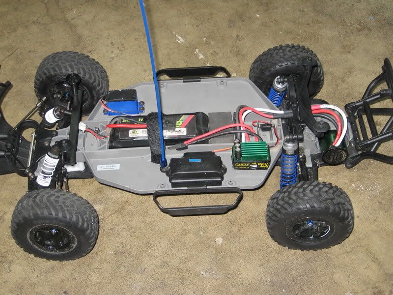

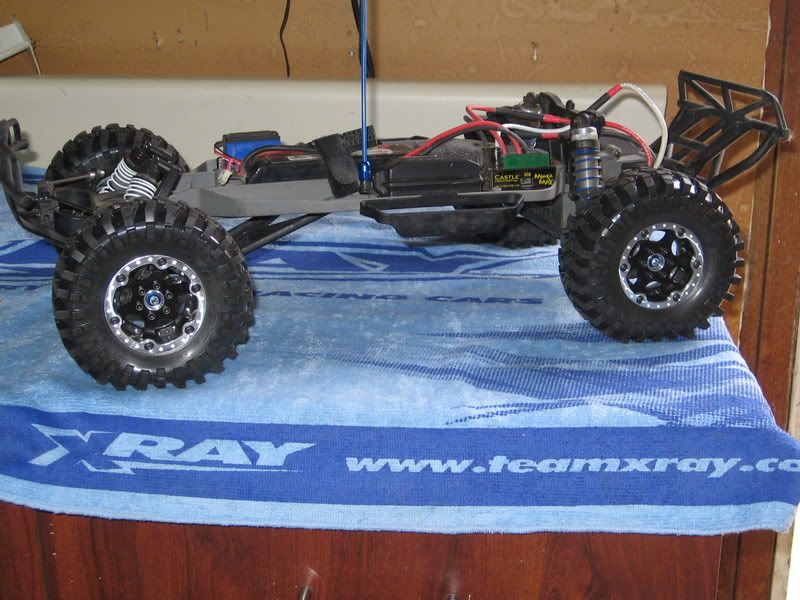

So I got home from camping and RVing across this great nation of ours and found a nice new toy waiting for me as well as all of the parts I ordered before I took off )I love it when a plan comes together)

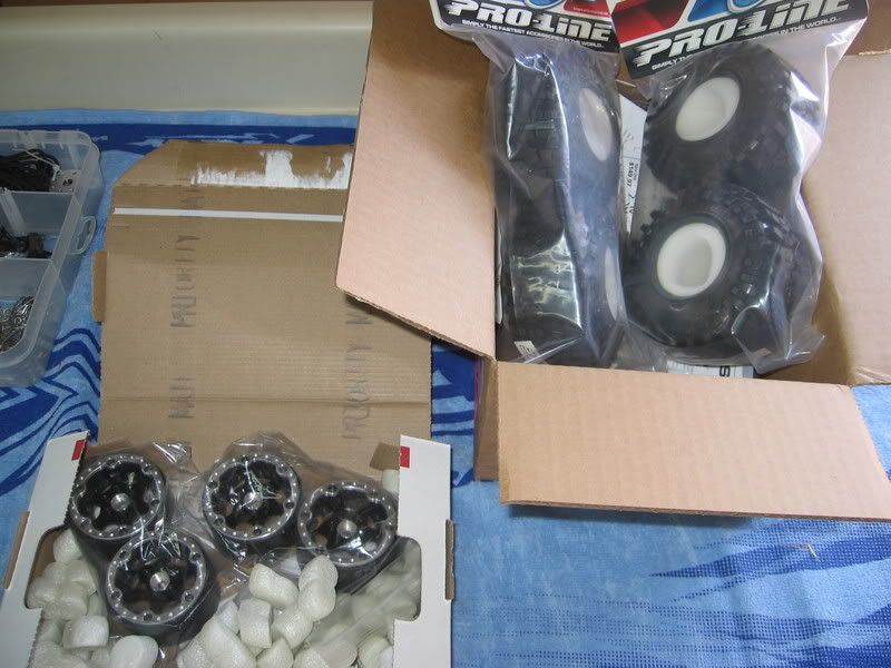

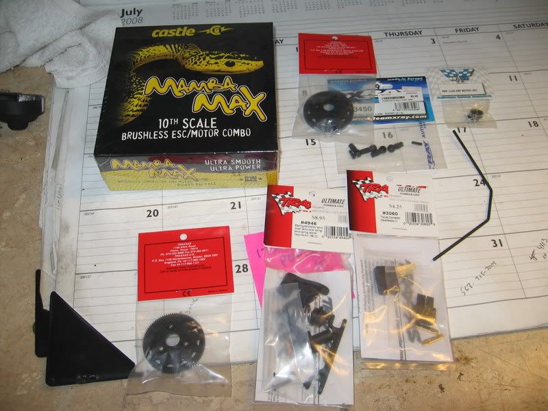

Parts purchased:

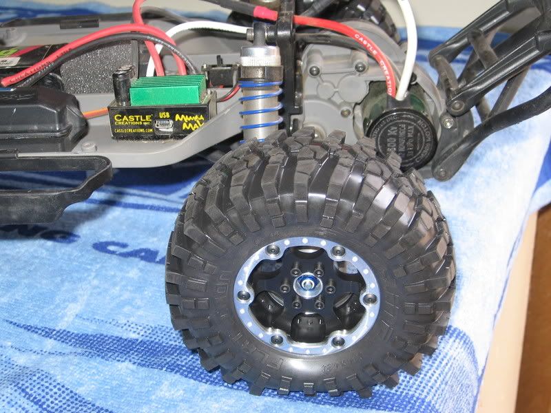

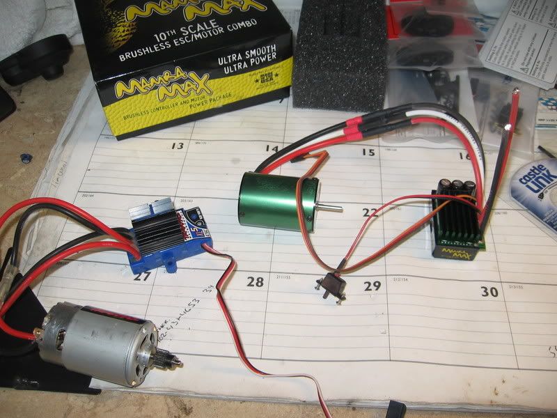

• CC Mamba Max combo with a 4600KV brushless motor http://www.ultimatehobbies.com/istar...d=CSE1805!1001
• 2 different spur gears (90 & 83T) and 2 pinion gears (16 & 19T)
• 2.2 CAC Traxxas Slash Beadlocks
http://shop.rpphobby.com/product.sc?...productId=1018
• Pro-Line Flat Iron M3 2.2
http://www3.towerhobbies.com/cgi-bin...?&I=LXUWD6&P=7
Mod parts:

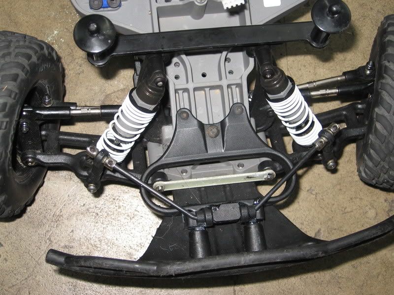

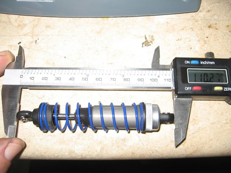

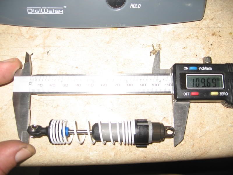

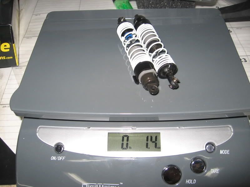

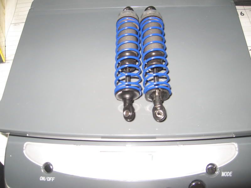

• I removed the rear shocks and installed the front shocks off an XRay XT8
• I removed the front shocks and installed some Lois 8eight front shocks
• I fab up a front mount and then installed the rear sway bar off an XRay 808 on the front
• I stripped off the chrome from the stock wheels to achieve the black rim look
• Running 3s 5400 20C lipo (Can you say fassssst!... I need to GPS it)..
Builders notes:
1. Dam I forgot how easy it is to work on a Traxxas product (it’s been a while), everything went together rather nicely.

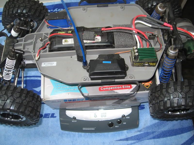

2. I'm using a 3s 5400 20C lipo and it just hauls but! and the CC combination is working quite nicely together, so far after a total of 55 minuets of all out bashing / beatings the beans out of it!, no heat issues at all.
3. I need to remove the front swaybar and see what the difference is (?) with it the front end has little to no sway / rocking and it’s really hard to flip it on or off the dirt.
4. I love the shocks!!!!! I'm using 20 weight on the rears and 25 w in the fronts, the overall added weight is a total of 1.8 oz. (just under “2” OZ) for both fronts and rears.
5. It’s really NOT a basher (?), I took it out the local soccer field and rolled it every time I hit a wrought and it barely had any traction on the grass (?).. I'm thinking it’s mainly a open gravel, parking lot, smooth area kind of truck (??) maybe the new tires will help (?)
6. It does take a nice beating without to much damage at this point.
7. I need to find an aftermarket body for it so I can have it painted in my fighter motief, I'm thinking maybe something from the UK (?)

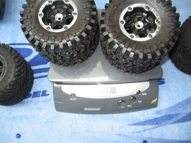

8. The total weight difference between the beadlocks and the stock tires is sickening, it added a total weight of
Here are some shots.. I hope you enjoy them..

And here it is fully “4x4” modified version on 5s ..
Nothing!.. Hahahahaaa..

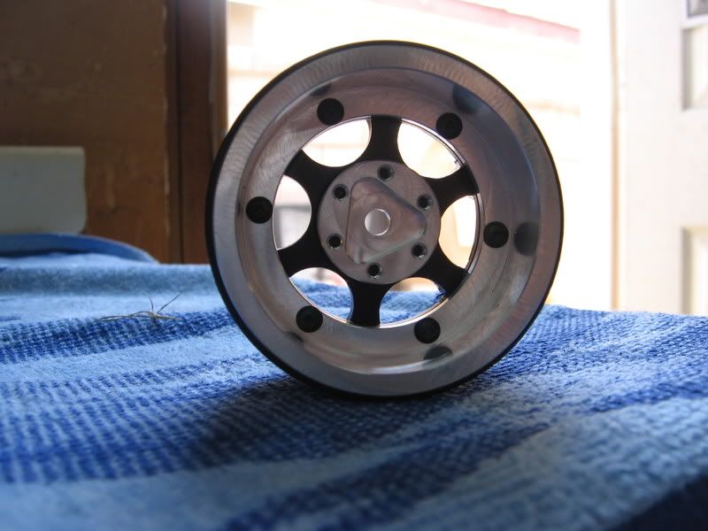

You are crazy. Those wheels are cool. Does the slash still have different offset wheels? Triangular hexes, what is the world coming to.

Yes these wheels are actually made for the Slash with the same offset as the original wheels, here is the link to the rims if you want some..
http://shop.rpphobby.com/product.sc;...productId=1018

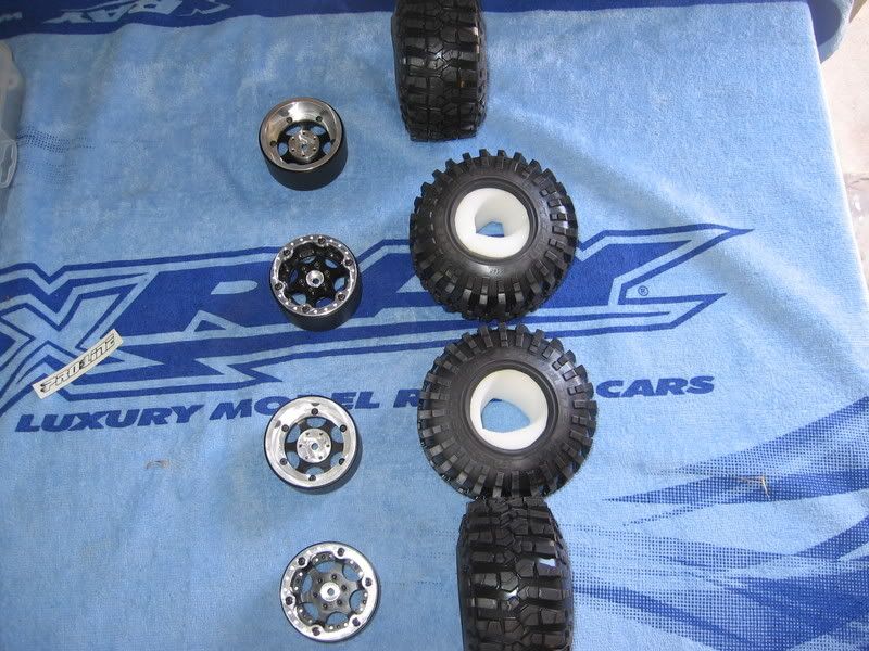

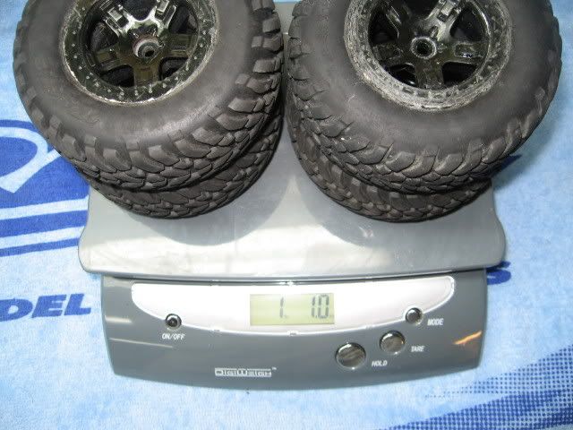

They are heavy though.. here are some side by side comparison for you.
Stock wheels and tires weigh 1.1 once.
COC beadlocks and Pro-line tires weigh 1.13.8 once
(for what it’s worth)
The total weight of it RTR without a body is exactly 6 lbs.
