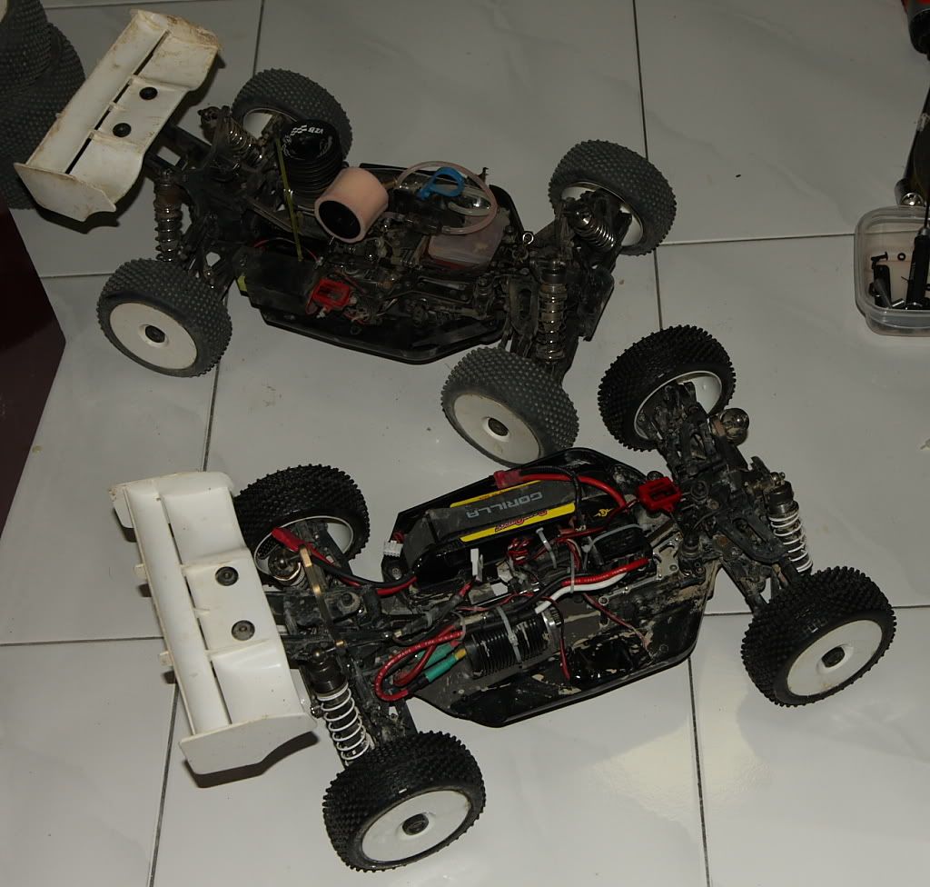

Well, it's Saturday night & the weather has been kind to me. Went bashing at out local track for a couple of hours. I am happy to report that both escs survived my torture test. Ambient temperature was around 32 to 35 deg C with high humidity :

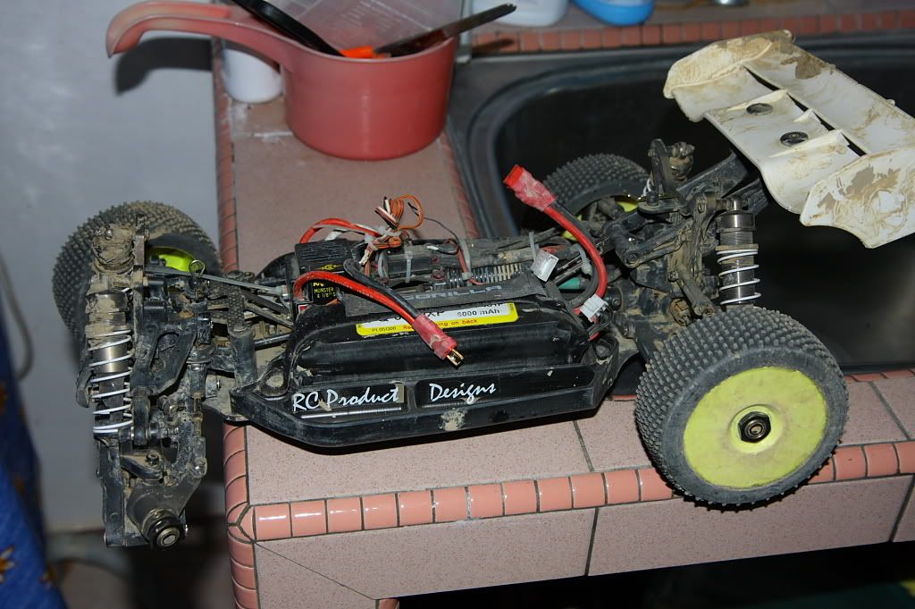

Car 1 - HN CR X1 1512 2600KV 4S 600mah PQ lipo gearing 13/48 (modded V1)
Started with this car first. Went round & round the track & had a few rounds with the nitro guys. About the 3 or 4th time they took a rest due to fuel depletion, I decided to stop to check check. Noticed that the fan was not running - it was jammed somewhere. This fan was powered off the UBEC. Esc was still running though & for how long without the fan not sure. So decided to stop for the day & fix up the fan later.

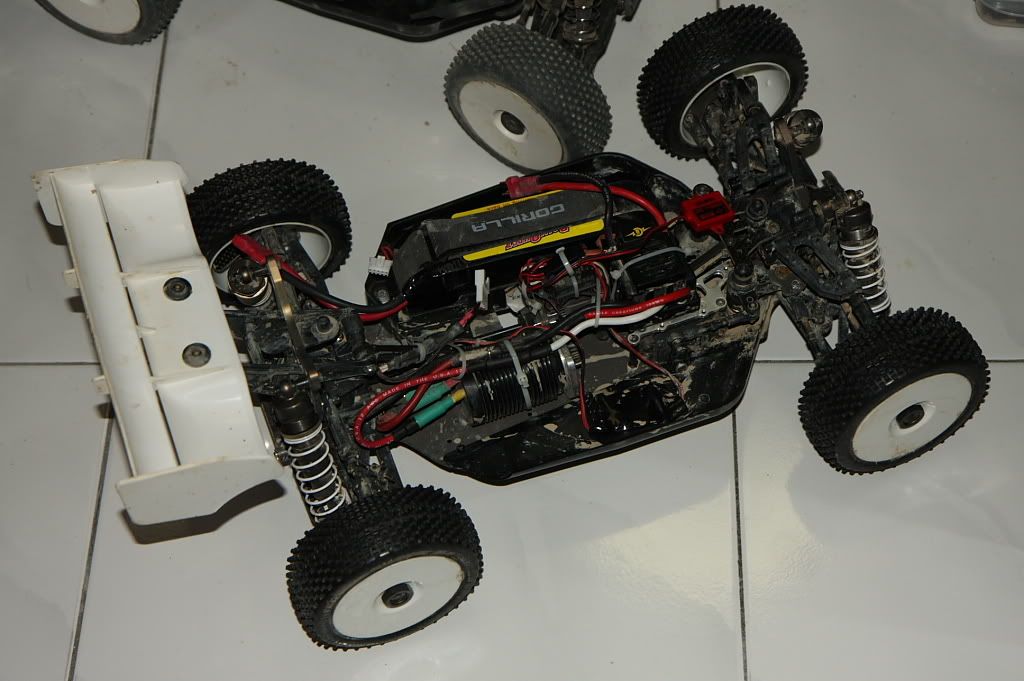

Car 2 - HN X2 Neu 1515 2000KV 5S 5000mah 13/48 gearing (modded V2)
I am really starting to like this car. Only the second run so far this time out. The first run ended with a busted Tekno Neu 1515 2200Kv motor. Thie time round, ran the car until LVC kicked in at 15.5V. Esc is unharmed.

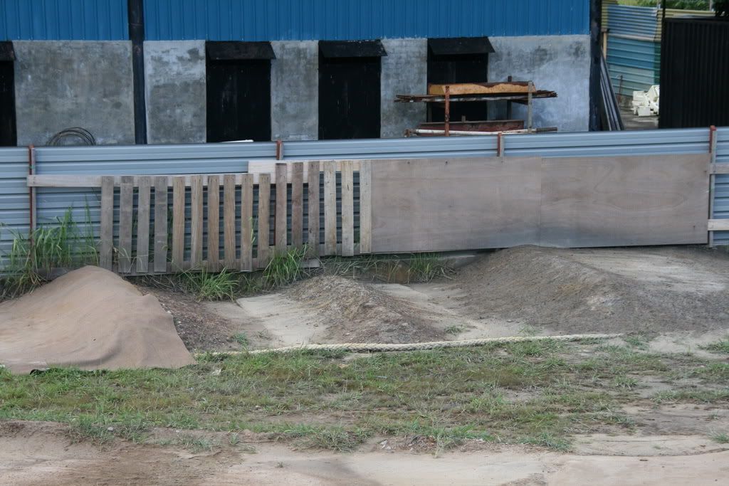

This is the track layout :
Track left side
middle section
Track right side
Grandstand
The big triple at the far side

Once again, I'm relieved to report that my modded V2 in the X2 is alive & well after a brief bashing session at the track Probably ran 1/2 a pack through before I moved on the next vehicle in line...
I will be racing the modded V1 in a X1 CR tomorrow among all the nitros. Should be a nice test.
