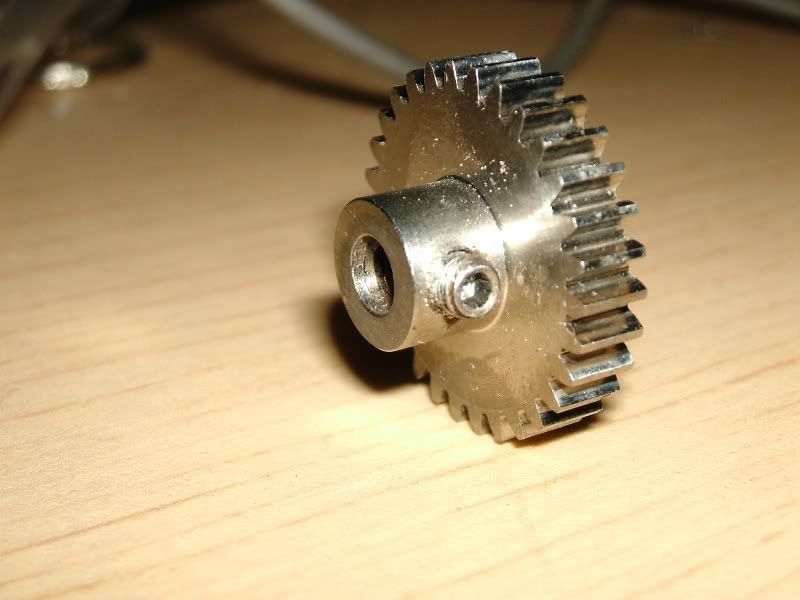

I got a 30t stainless steel pinion from Kershaw Designs and a couple spare Jato spurs 56 and 58 (fresh out of 54s) if your interested. I've been debating on offering to sell the 30t to you. I really don't need the pinion anymore.
Per the speed calc the 30t gets my setup over 60mph. I don't need that kind of stress in my life anymore. I've tried it out a couple times. It get's my setup (G3R, G1, 4s 1515 1y/s 54t) hot fairly fast so I have to pay attention to the temps. With todays economy I can't afford to pay attention. I have to check the temps more often when using the 30t so that mean replacing the temp gun battery more often.

I don't think you'll have the heat issues with the lower kv Neu you have. Eyeballing it on my G1 It looks like 54 -68t spurs shouldn't be a problem w/ the 30t.
