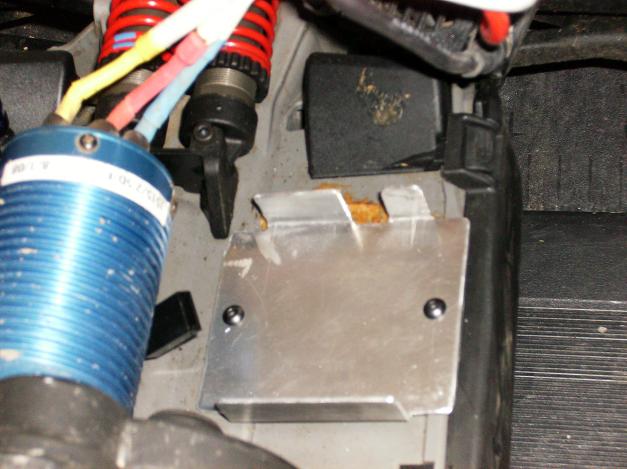

I started out with some GOO holding my MMM on my chassis, even raced at the bash with it like that. I knew it wasn't ideal, esspecially when I wanted to hose my truck off after getting covered in mud at the bash. I finally made a plate for mounting the MMM in place of an EVX-2. The MMM still needs to be zip tied to the plate but there is at least that option now. I also used some sticky duct gasket from work under the MMM, it provides additional holding power and some impact protection. There are lips front and rear to make sure the MMM doesn't move in a crash or hard landing.
