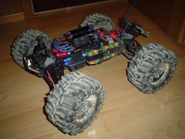

Hey dafni do you have any more pics of your truck with the lst tires on it? Do you think it could be possible to put those lst tires on a 40 series rim without cutting them?

I think LST tires on 40s will be pretty tight. I use mine on TwinForce wheels.
Here are some wheel dimensions (diameter x width) :
Maxx: 87 x 56mm
40s: 102 x 86mm
LST: 87 x 77mm
The LST tires fit on standard Maxx wheels no problem, but it makes the tire more narrow. That's why I used the TF wheels in the end, they are a bit wider.
Pics? Not really any new ones. Here are the only 3 I have here.
