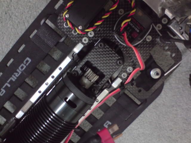

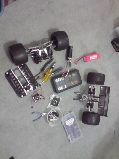

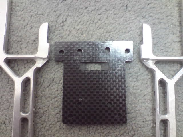

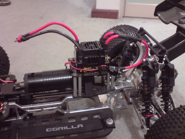

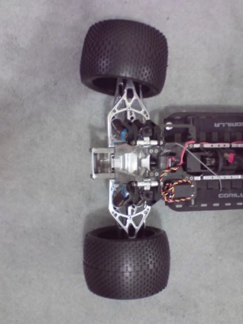

I got my gears from Amain, ordered Tuesday, arrived Friday, cant get much better than that!! So i went about modding my CD mount and my frame rails to fit with the larger 48t spur gear. I cut a slot into the bottom diff plate for clearence, and also notched out the frame rails. I also went about direct soldering my motor to the MMM wires. I had to make some small extensions to get them to reach. I think the MMM install went great and im happy with how clean it looks. Here are some pics...
Down for maintanence
slotted and notched parts
wire extensions and motor with wires directly soldered

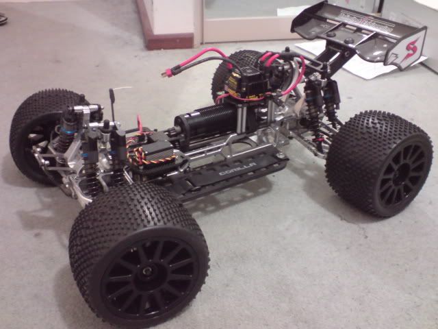

Some pics ready to run!!
Read on to see the truck with the MMM ran...

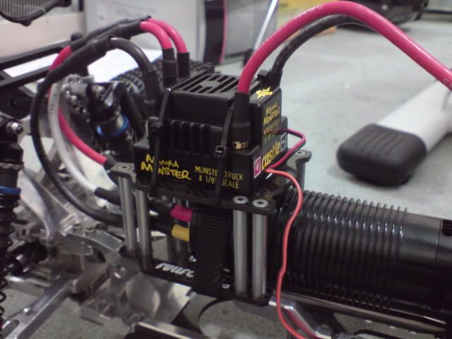

... so i took it out for a run this evening.
WOW is all i can say With the lower gearing this thing came alive. Still no wheelies, but SO much power, and all of it useable. Handled awesome as before. Mostly kept all four wheels planted round quick corners and pulled some nice 4 wheel drifts. The MMM ran excellent!!! It was really smooth on startup, no cogging at all, the brakes were perfect and it really delivered the power smoothly through the whole throttle curve. So happy with its performance, my temps after about 15-20mins were
motor 110-120F
ESC 120-130F
batts 80-90F
The fan only came a couple of times, but after i let the truck sit for around 10 seconds it went off and was ready to go again. I'd like to say that the MMM really can handle any motor thrown at it, great job Castle!!!

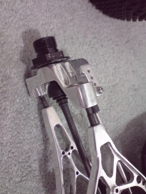

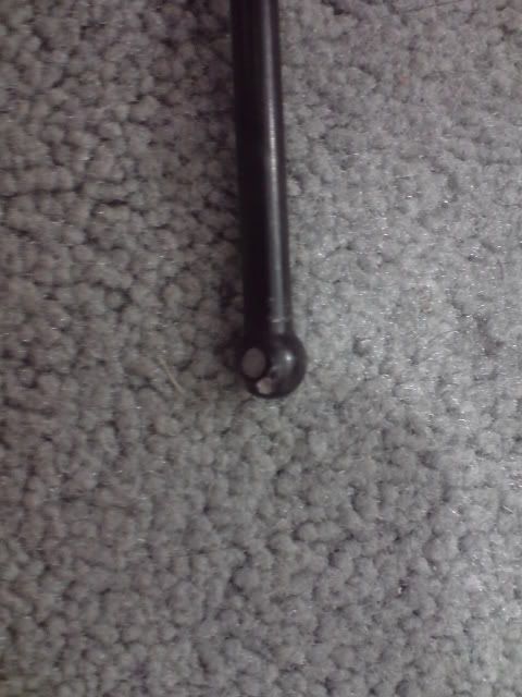

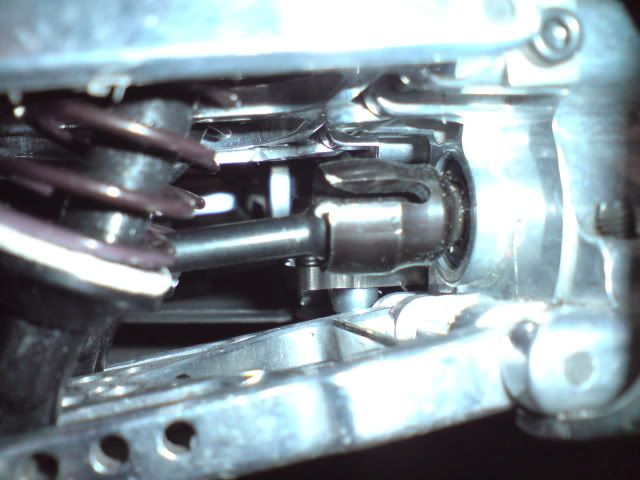

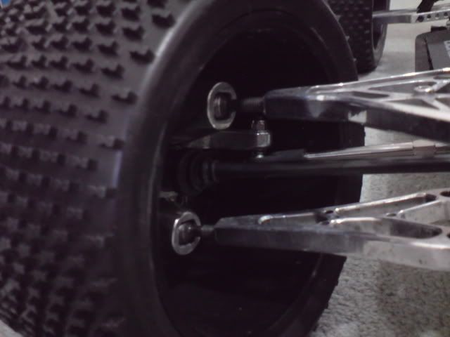

Now for the aftermath, can you spot whats wrong with this pic
The pillowballs screwed out, which made the driveshaft pop out of the cup, and under some hard breaking, sheared the pin
My question is, is there an easy fix for this problem? Can i get the pin out somehow, i was thinking about drilling it out, and then put a drill bit or allen key in. Much like the roll pin mod people do in the 3906 tranny's. Any suggestions, i cant wait to run this thing again!!!

The pins are surely put in with a hydraulic press, so you should be able to press it out if you have access to a press. Then press a new pin back in. Yes a drill bit or allen key should hold up just fine. Nice work on the vehicle, and it looks to run pretty well with the MMM. How much does that thing weigh loaded up? It looks to be kind of heavy in the Video. Just curious. Looks like you have a new bouncing baby boy on your hands. Way to go Jordan.
i have got a mate whos a mechanic, so i should have easy access to a hydraulic press. It is a bit of a beast, 14lbs all loaded up. It sure did run well with the MMM V3, time will be the test now i guess, hopefully it doesn't crap out on me after a couple of weeks.
