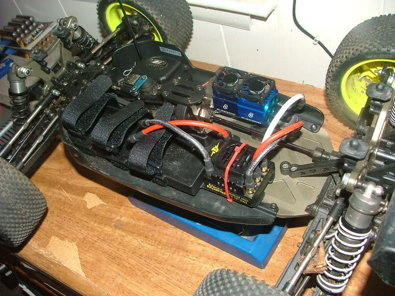

So heres what its got.
8T Race Roller
Losi Brushless conversion
Medusa 36-60-1600KV with Dual Fans
Mamba Monster Max
5S Lipos
Hitec 5995TG

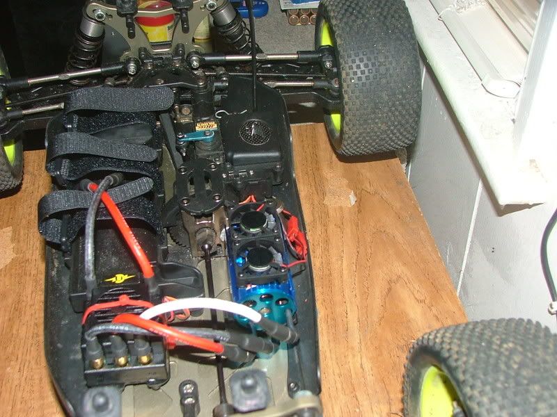

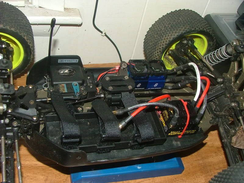

Thats about it so far... And no, the monster max is NOT just held down with that zip tie. The Losi kit is setup for the Losi Xceleron brushless ESC, so its just a flat plate with holes for the losi ESC to bolt down to, however the Monster Max doesent have mounting bracketry so I double taped it, but in the event that it decides to unsticky thats why that badass little zip tie is there. Sorry to go on a rant, I just dont want it to look 1/2 assed
Im getting about 22-24 Mins on my 5S 4000MAH 20C Packs. Motor gets to about 100, ESC around 75 and battery around 100.

Nice 8, what heatsinks are those?
Thanks.
