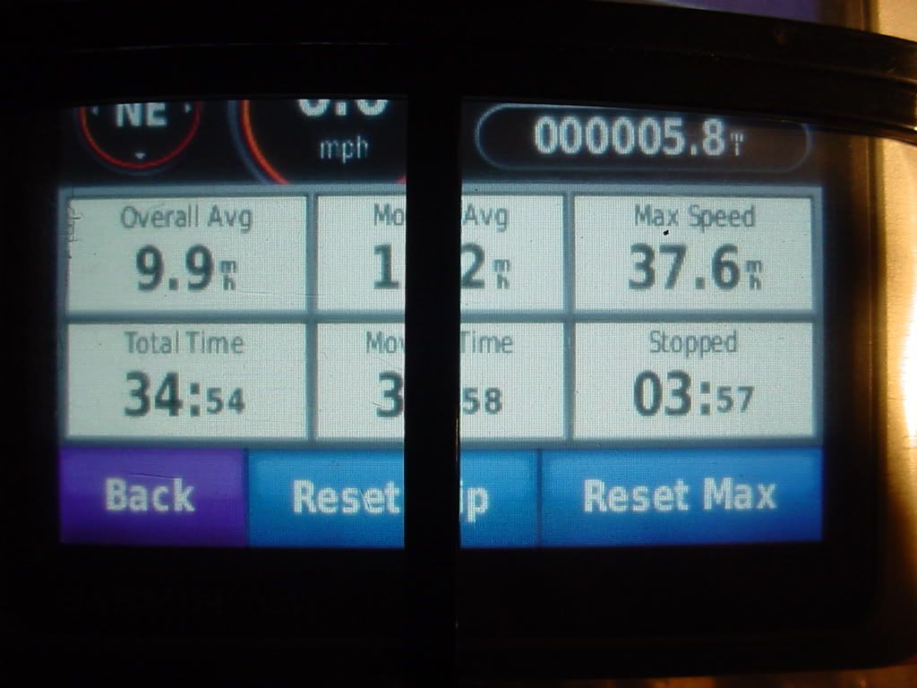

I'm running the 36-60-2000 in my E-Revo
The 60mm is no slouch. Here's a GPS from a 4S run.
4S tops out at 37.6mph
Another Member here ran 55.7 mph top speed with the exact same setup only on 6S.
I would go with the 3670-2000
My 60mm is geared 18/52 with mod 1 gearing. ESC is a MMM V2
