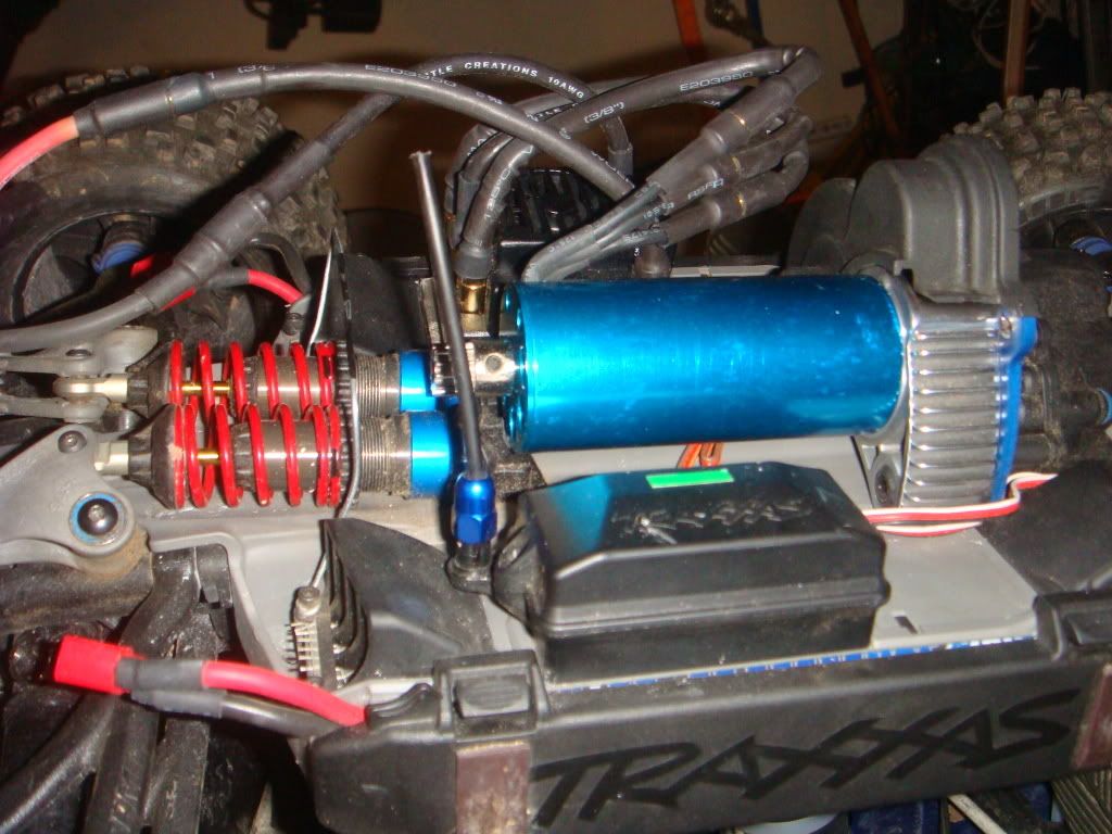

Here is my 80mm squeezed into my E-Revo, and a extra pinion on the rear output just for fun.[IMG][/IMG]

That is not an insignificant sized motor...
I think I'll stick a propadaptor on the rear shaft of mine, then paint it too look like one of those hypno-disc spinning things as it runs...

Humm would a small fan fit on the rear shaft? (pulling heat out of it)
Yes but making one fit would be interesting, but thats an AWESOME idea and when I get my 80MM for the LST2 Im gonna give it a try with my 40MM fan
seems to me that would cause alot of unneeded drag on the motor and cause more heat
