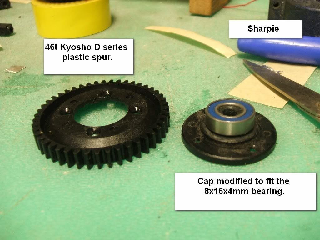

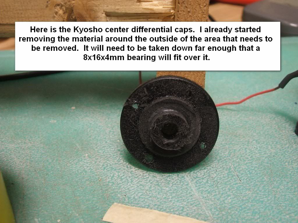

My thought is to look at the part of the diff where the output comes out of. Is it one piece with the spur, or does the spur bolt over it, like a cap? I am guessing that it is made similar to the plastic kyosho spurs. Can you maybe use one of them to get a 10mm output insted of 12mm?
Depending on the diff output size, most are 6mm, you should be able to turn down that area to fit a 10x16 bearing. Then do the same on the cup end and use a rcm kyosho mount and matching front bulkhead.

Okay after looking at the exploded and a "normal" Kyosho spur here. I think I see what you are talking about James. If the cap that goes on the differential is a solid plastic "nipple" like the spur here and shaft is 6mm there should be plenty that could be taken of if needed. I'm placing an order for some wheel nuts and will add another diff cup and some 10x16s. Was hoping that once I got the DST I would be able to find a way to get it's differntial w/ the plastic spur to work in the LS10. Put that little head ache on hold for now. Good idea.

I would also try the reg kyosho 46t plastic spur. It may fit on the diff directly and eliminate any need to mod that "nipple". Having it turned down to 10mm would not be too difficult but I prefer bolt on soultions.

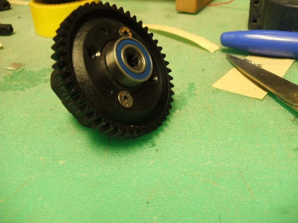

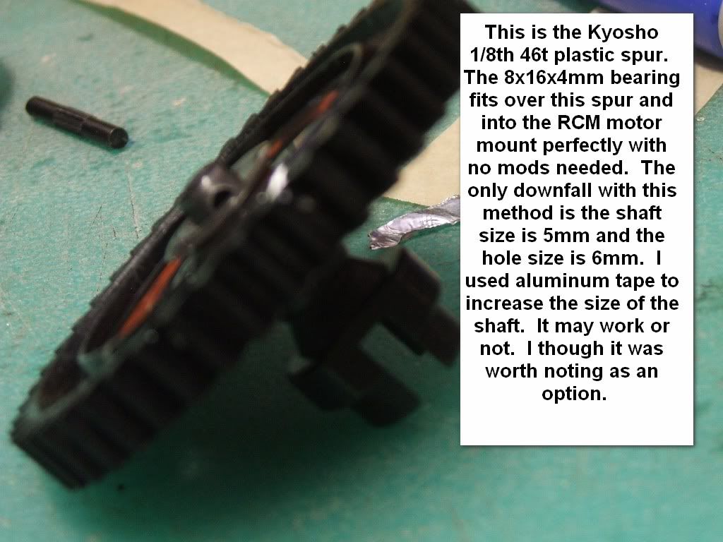

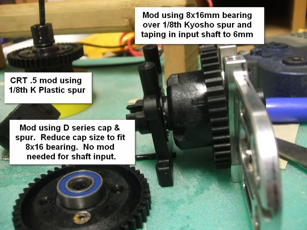

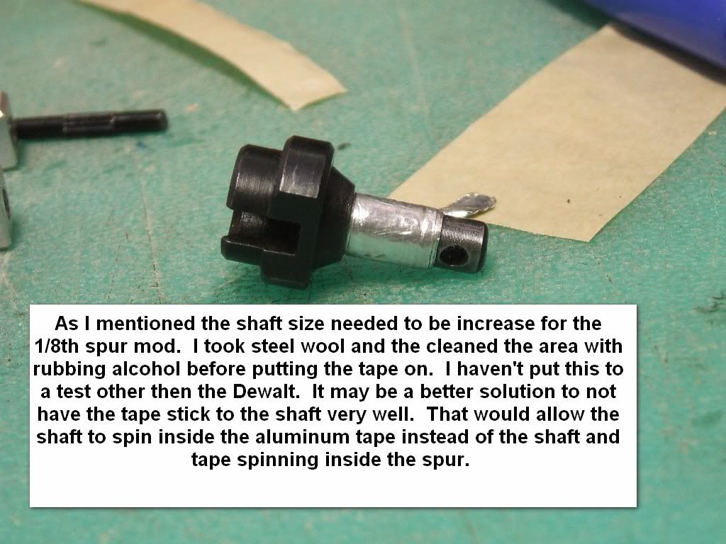

Thanks for the help. I gave both of the ideas you had linc a try to see how the would work. They both turned out good. One has a advantage over the other due to size of the dst shaft is 5mm though. I also took some time and got the plastic spur from kyosho to work on the crt .5 center differential. I use it in my ls10 so it will work in really any of the 1/10th scales that use a center differential. I will be putting together a write up on the mods needed for it. Now I need to finda new center cup for the crt .5 The manual doesn't list a part number an I can't find one on a-main. Maybe it is the same as the front/rear differential cup. They are just keeping it secret from me. You got a UPS box on the way to you. Got it out of here a few days ago.
Here's what I've come up with. The mod to the existing cap and spur will work the best due to the 1/8th spur has a center hole of 6mm and the shaft on the axle drive is 5mm.
