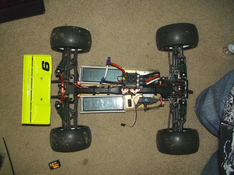

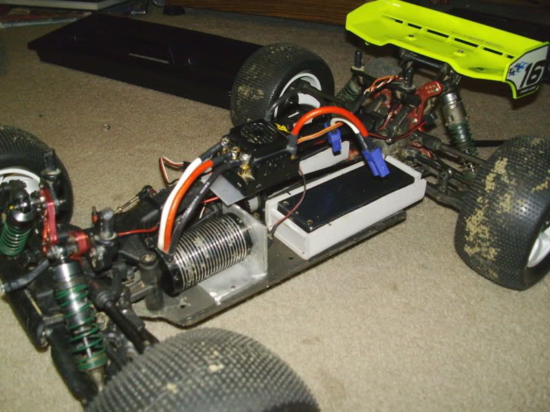

01.10.2009, 12:28 AM
Picture Time :)
  (#384)
Metallover
RC-Monster Spudgunner
Metallover's Avatar
Posts: 2,353
Location: South Dakota
01.10.2009, 12:35 AM
Thats a big truggy. Makes the MMM look like the MM in the first pic. Is it heavy?
  (#385)
brushlessboy16
brushlessboy16's Avatar
01.10.2009, 12:50 AM
Its not a big truck, just really long.. Look at the batteries- they fit between the rear diff housing and center diff mount... MMM Runs like a champ though :)

Do you think you could get a closer shot of the trays? How hard was it to bend the kydex? Where did you get it? How much money?
  (#387)
brushlessboy16
01.10.2009, 01:03 AM
Its 3/16 kydex plastic, was maybe 10 bucks for a 24x18 sheet. Its easy to bend the stuff with a plumbers torch and some patience- all the dark marks you see are burn marks

01.10.2009, 01:13 AM
Looking good... Just get some sticky foam from the craft shop to line them. The stuff kids cut out for pictures works well.
Got the extra mile and get the dremmel / sandpaper to the edges of the trays and motor mount. You've put so much effort in go the last bit...
