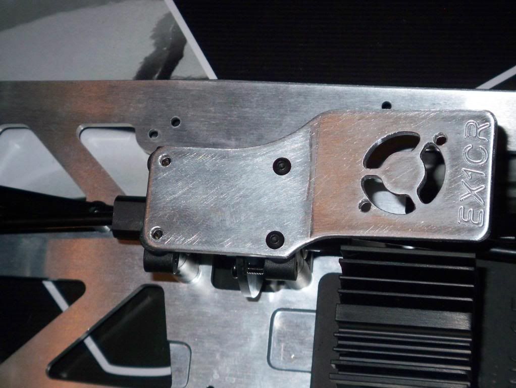

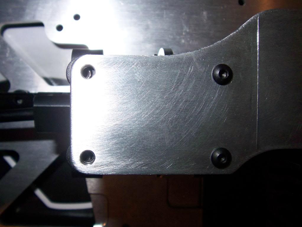

Guys,
Today I received the top plate from RCPD and does not seem to fit too well. The top plate is from the E-Jammin' kit to the best of knowledge. Now I know I can easily modify the plate to fit but I have some concerns since I also ordered the motor plate. Ofna says the DM-1 Spec drive train is based off the Jammin', correct? Here are some pictures below--let me know what you think.
I really like the plate because you can arrange it to have the ESC close to the front as well .

01.19.2009, 10:53 PM
You should be able to open up each of the four mounting holes just a little bit and you'll be good to go. You will also probably need four 1.5mm spacers (I used the black ones that Ofna sends with their kits for the hinge pins) to raise up that top plate enough to accommodate the 51T spur. Check the spare parts bags that came with your DM-1 Spec...you should see some small black plasitc spacers that will work perfect.

01.19.2009, 11:03 PM
You are 'da man! I did peek under the motor plate and looked like it needed a lift. I will find the 4 spacers and do a little drilling. Cheers!
