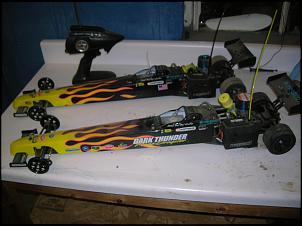

OK guys...need your opinions...
I can get my hands on two Megatech Dark Thunder Nitro Dragsters.
A buddy has access to a warehouse that we can set up a strip.
Now my question, do you think it would be worth converting it to brushless? Has anyone done it before?
It has a two speed tranny that goes into a rear straight axle. The only relief for the drivetrain is the Clutch bell.
I will need to use the mech brake unless I can rig something in the, so called tranny. (Haven't looked at it close yet)
What do ya think???

looks like a great conversion, the easy route would be to convert it to straight axel but keeping the belt drive and two speed shouldnt be that hard

I'd get rid of the 2-speed and the clutch since BL has plenty of torque. Use the motor brakes to save weight. I would run 6s on a MMM and use the punch control setting to avoid tire spin. From what I've seen those dragsters do, a setup that gives you a 60-70mph top speed would be fine.
6S?
I was thinking a little less...that would be a huge brick...I could possibly do 3-2S along the chassis.
I was thinking 4S low Mah...being that it is a dragster.
I was actually thinking of using a combo of both brakes to control a stop...

6s 5000 would be a brick. I know- I have one! 6s 3700 would be sufficient. Look at it this way, the car is gonna have sooo much more torque than the stock nitro motor. With torque taken care of; weight = traction. Putting a brick in it might not be a bad thing!
Low-capacity cells are OK, as long as they can supply enough burst current not to hold you back at the starting line! Adding a few extra capacitors on the main ESC leads would be a good idea, too.

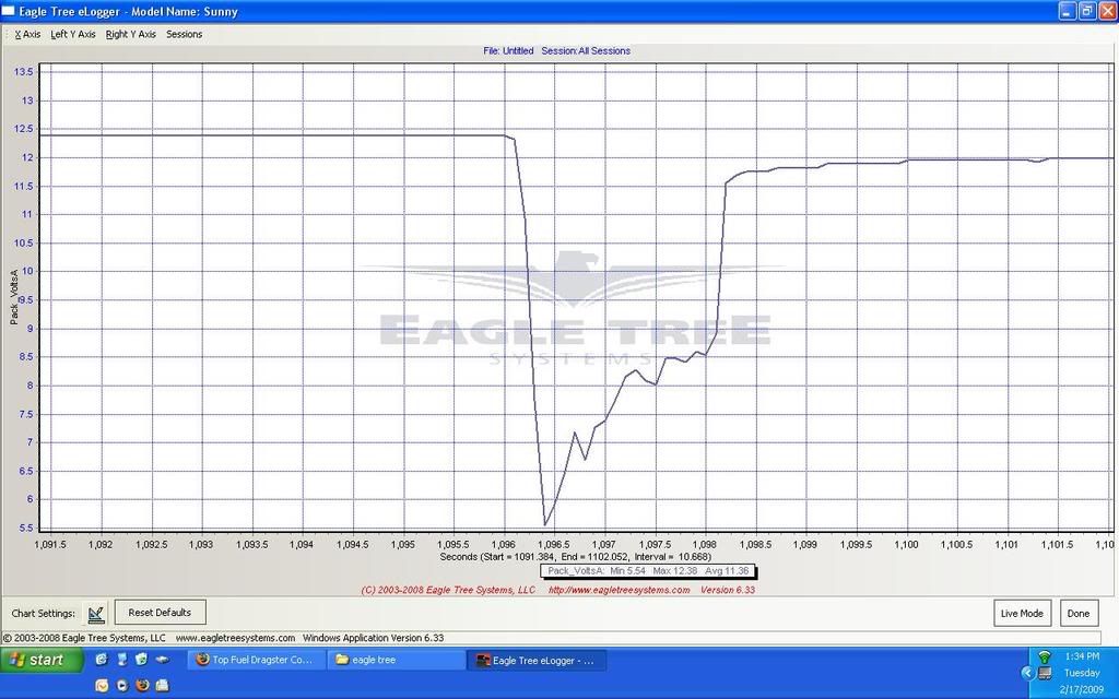

What you have calculated is continuous power. The set up I mentioned will peak at about 1100W due to voltage draw down as well as the shear amount of current it will pull on initial start up. Drag racing puts conventional thought out the door. And you don't really want "all the power you can get", mostly because the limiting factor is almost always the available traction. Traction is pretty hard to control with a low Kv, high voltage system as the torque is too much to control.
Just to illustrate, here is a look at the draw down of a 3S Thunder Power 3300mAH 25C/50C pack within one pass I made:
We run with LVC turned off so as not to mess with the flow of current, if any body is wondering how the pack went below 6V. It only recovered to about 9V at the immediate end of the race but, normalized around the 12V mark afterward. This is why it's very important to use high C rated packs, so that the recovery phase is quicker and the end voltage is as high as possible for top end RPMs.
I have no idea what the real power output of my dragster is since there is no way to measure the current demand in it. I estimate it to be in the 200A range, so a good estimate will be around 1800W or higher. My Litespeed dragster does the 132ft at a best ET of 1.45s @ 88mph+, just to give an idea of what's going on.
A shameless plug here, but check out my website in my signature to see my race cars and such.

Oops.... So drawing the cells down that far for such a short period wont hurt them? Have you tried adding more caps to the system?
