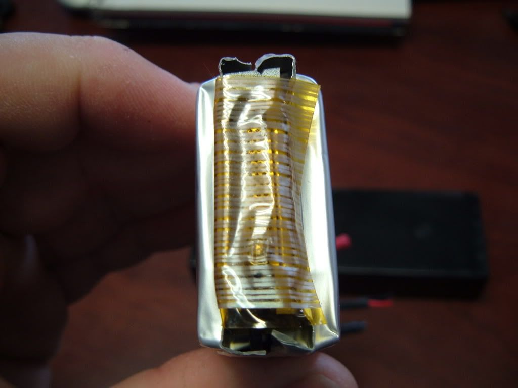

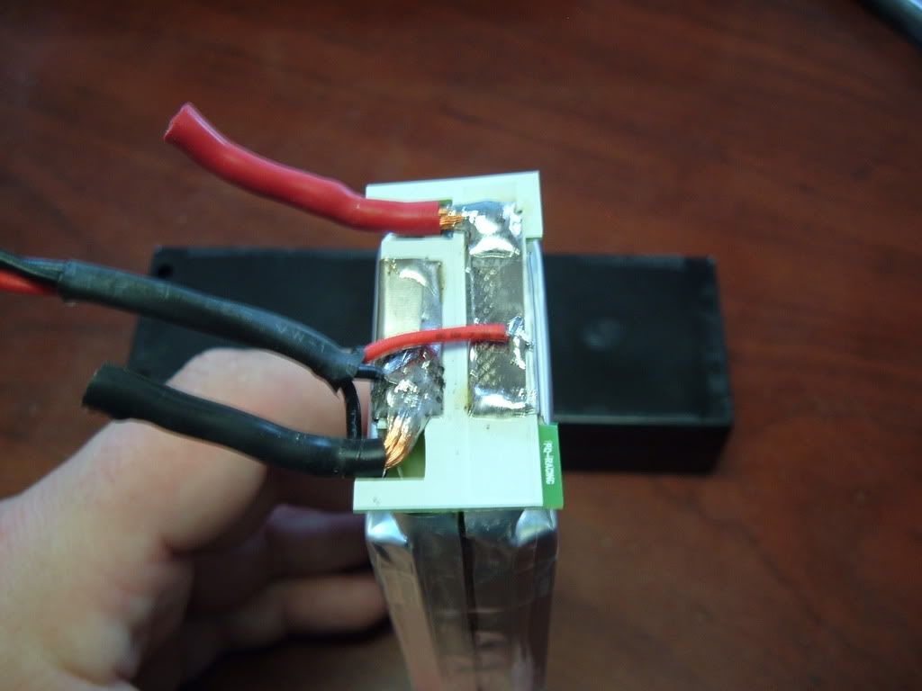

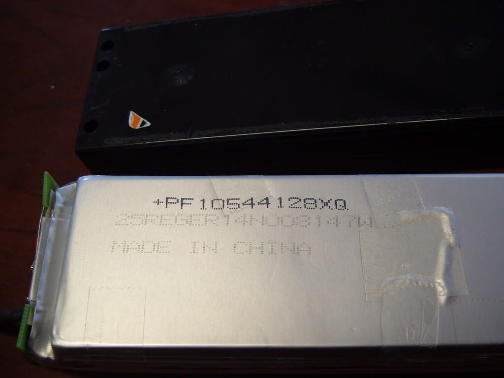

Insides of a Polyquest 5000 30c 2s hardcase - 02.25.2009, 03:22 PM
Got a PQ hardcase from a member here to fix the external wiring. I popped it open and look what I found!
Made in china??? I guess that enerland does have some chinese cells in their lineup, or polyquest is not using enerland cells? I thought that polyquest was enerland's in house brand, but I may be wrong. Anyways here are few other pics of the cells. Note that the cells have the pos tab on one and and the neg tab on the other. I have only seen enerland cells having this feature, as all of the other chinese cells I have seen have the tabs next to each other on one end. Zippy-r packs appear to be made of enerland cells too.

Interesting. So they are Enerland cells? Just made in China?
  (#74)
02.25.2009, 04:33 PM
They are the same design as enerland cells, and I have never seen that design used by any other mfg...
  (#75)
Jeremy1976
Posts: 537
02.25.2009, 04:36 PM
Hmmm, so either they are Enerland or they are bullshitting about the cells in the packs they make... For $130 new for this pack I would hope they are Enerland.
