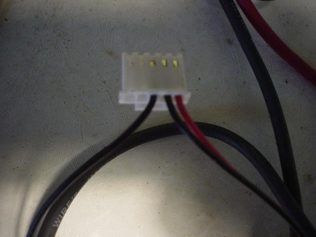

ok i have the jst xh adapter and the hyperion adapter. I have a max amps battery that seems to need a different adapter cause the charger is not reading the battery right.

That is a hyperion style tap, but it isn't pinned out right. What is the pack? 2s I am guessing?
---JRH---
02.22.2009, 04:52 PM
Yeah, the pin out is different from most Hyperion connectors I've seen. I usually just reorder the wires in all the connectors so that I can use any balancer...

its a 4000 2s saddle pack. how is it supposed to be set up?

like this
http://www.maxamps.com/HYP-2S-Tap.htm

that works. thanks. mine was set up for a blinky balancer. drove me crazy lol
