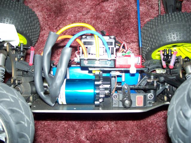

Got the medusa 36-50 and hobbywing esc installed and took it for a some quick runs,the esc is a pain to program to me,and am waiting for the programming cards to arrive from rcm,but I got it programmed enough to run it on pavement and it was a tick slower on 14 tooth pinion,the same setup as the velineon combo I had before.18 tooth will not fit as it touches the motor mount screws.The fan on it runs constantly and am not sure I like this esc yet,but the hot weather is almost here and maybe this is a good thing.Massive footprint for sure but stayed cool and smooth for the first speed runs,withe the medusa getting about 130 with no body fitted.

I have 3 mamba max's ,which are much smaller and more powerful than the hobby wing esc( I know hey make a 150).Never thermal,and are much easier to program,right out of the box, because of superior electronics and software The problem with the hobbywing is not so much the hardware,but the instructions leave much to be desired,and they are HUGH in size for any 8th esc.I ran the current setup in the dirt today and was very happy with it after setting down and playing with the settings for a while, A great bargin,none the less.That being said,I'm going to go with another mmm esc because I consider this hobbywing just too big for a crt.5 , even though it fits(barely) as you can see by the pics. Gonna use the hobbywing in my mutilator truggy project.
