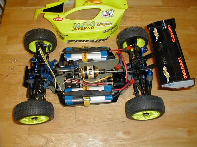

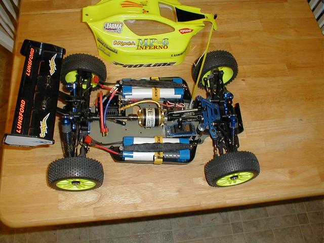

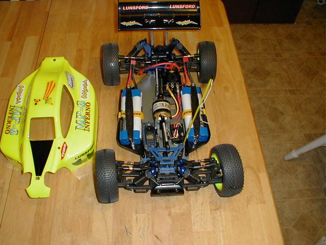

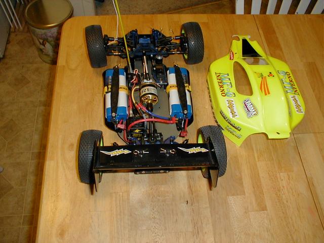

You mean like this?

Yes, EXACTLY like that. That looks great DLS II. What Kv is that then? Where can I get one? And what true speeds are you getting out of it? And how long of a run time?

DLS, how did you mount that motor? I love your setup.
Close up shots of the motor mount would be great.

03.19.2009, 02:08 PM
The motor is 600kv. It weighs 7.75 lbs. I've yet to test it. It should do 40-45 mph and run (I hope) 15 min. The mount was made by Monster Mike. I tried getting some shots of the mount, but they didn't come out so well. It's set up 6s A123. The outrunner is a Rimfire 42-60-600. The car is a Kyosho MP-6. I call it an EMP-6. The motor mount is secured to the stationary end of the motor with 4 screws. It bolts down to the front 2 mount holes of the center diff. It is secured by the top brace that runs from the top of the mount to the steering assembly brace. It came out very well. Mike's work-mount,brace,rear dog bone and design are superb! Don
