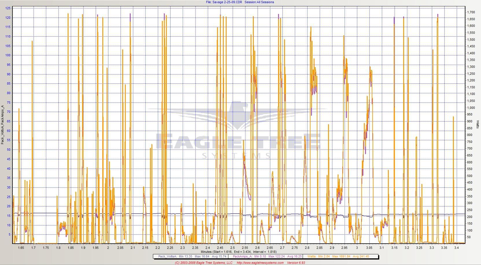

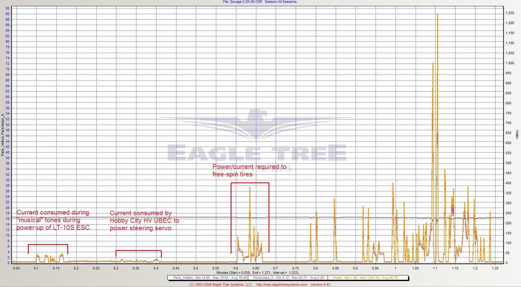

Whoever thinks the Savage X diffs (in Savage 25 bulks) are weak needs think again! A little bit ago I decided to test out the E-Logger V3 I received for Christmas in my most power-hungry truck.
From the pics you guys know this truck uses two batteries in series (2x 4s 3700mah 20C Rhino packs), and the input wires to the ESC hook directly to the Deans plugs. Thus I could only record data from one battery, but the current (amps) measurement is accurate because all components connected electrically in series will pass the same current.
The batteries had only a bit more than three-quarters of their charge left, because I was too lazy to charge them. The resting voltage when I first plugged the one battery in was 16.54v.
Here are the images (I left them huge for better clarity of data):
http://img.photobucket.com/albums/v1...age_graph1.jpg
http://img.photobucket.com/albums/v1...age_graph2.jpg
http://img.photobucket.com/albums/v1...age_graph3.jpg
The first image shows some random stuff I thought would be interesting to see.
Second, you can see the REAL power this truck is capable of. One peak gave this result:
13.73v (3.43v/cell average)
121.55amps
1,668watts
Remember, I am only recording for one battery. Assuming the other battery performed similarly (no reason why it wouldn't), here is the total input to the ESC:
27.46v
121.55amps
3336watts
Nearly 4.5 FRICKEN HORSEPOWER! All coming from a truck with a center diff too... That power level certainly isn't a fluke because it hits that peak over and over again.
Also, assuming that the E-Logger is properly recording voltage when the current spikes like that, these Rhino 3700mah cells are holding 3.43v (average) at 120amps, which is 32C. Very impressive for such cheap batteries!
The third picture indicates where I was accelerating hard, and then SLAMMING on the brakes. It is very scary to see such a heavy truck stop so quickly. Anyways, the red circles I believe are indicative of regenerative braking.
