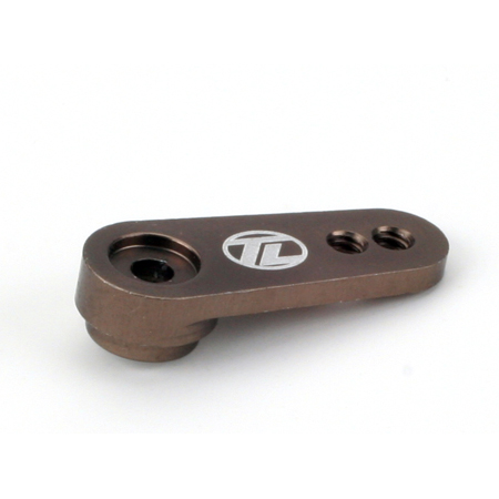

I had a similar binding issue with my 8B steering and realized that the arm that attaches to the servo (pictured below) would bind with the top of the servo case when I tightened the screw. I just dremeled a bit off for clearance and no more binding. I hope one of us gets you an answer. Good luck.

The problem was too much play in the Servo Saver in combination with too much play in the rest of the steering train. Replaced bearings and bushings, tightened the saver and it turns like it should. I think I just need to add some toe out and additional Camber to get to to turn faster in the corners.
