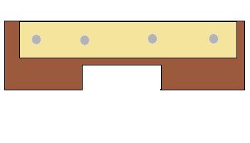

IDK the "proper" way, but I would put a 2x4 on ea side and put long screws or bolts thru, preferably bolts and washers. I tend to over engineer things, so maybe it could be less, but why go halfway?

04.01.2009, 10:29 PM
Yeah, I like that idea. Although, the notch I need to make is bigger than I'd like and there would be only about 2" of "meat" left in the 2X6. I want to attach some U channel metal on both sides, but still makes me a bit nervous.
Borrowing Finn's pic, this is about what I'm looking at:
There is good news though; one of the beams is actually comprised of two shorter ones secured together with about 6 feet of overlap (effectively a 4X6 for that length). So that will be easy to brace by lying a 2X4 (or two) on top and screwing in place. But the other beam is only a single "layer", and securely fastening a 2X4 might be problematic. The beam is fairly "wiggly" so there doesn't seem to be too much stress on it, but I still want to make sure it is solid.
