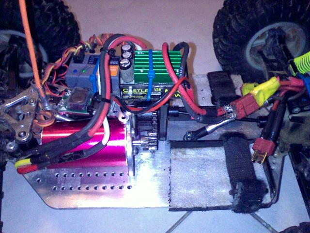

from wat i see is that most of u run medusa 36-50-3300 on 3s m, so ive posted a pic of my crt.5 , wat would be the best setup for it ,
should i go with 4s or 3s ??
2 4s in parallel and medusa 36-50-1600kv
or
2 3s lipo in parallel and keep my 7l motor or get a medusa 3300
which will be a better setup for cool temps , about 40mph speed , and 15+ min runtime??????

For 4S I have the 2200 50mm medusa. Easily 40mph, closer to 50. That 7L motor is pretty crappy and hot.
I have a 4s 2100 batt and get a long time bashing. I know I've done at least 10min on the track, but its not really a track car, so I can't promise you those runtimes.
Neu also has 4S 2500 batts as well. Flydma has some for way cheap. I would have a hard time seeing you not get 15+min on those @ 40mph top speed. Mike's batts are 2500 cells as well, tho he usually sells them as 2p. a 4s1p pack of those would smoke as well and get power and runtime. Not sure what the dimensions are, but I'm sure they can be made to fit. 110mm packs fit nicely on the chassis.

i m8 get a couple of zippy or rhino lipos
but should i get a medusa 50 mm 1600 kv or medusa 2200 , because i already have a 18 teeth pinion and i want to use it ,
now , should i keep the setup ( shown in the pics above) and use 2 4s in parallel or should i return it like stock and use 1 2150-2200 mah 4s 20c pack ??

I understand you want to use your 18T pinion, but I wouldn't let a $10 pinion determine which $105 motor I buy. I really like my 3300 on 3S (12T - 14T pinions) and to be close to that in speed and power on 4S would be the 2200. The 1600 seems ideal for at least a 5S or even a 6S system.
