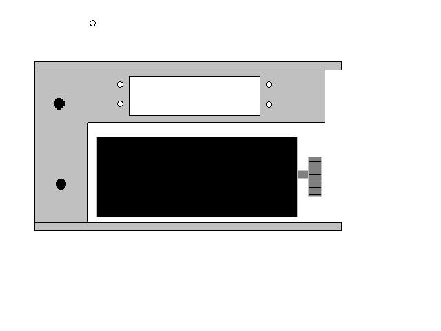

I thought about putting the motor right on top, and its an easier thing to design, but I decided to make it offset so that the CoG was a bit lower from dropping the motor a couple cm, and also to keep the motor on one side to save room for the steering servo and maybe radio mount on one side opposite of the motor.
Neu motors are 44mm(?) in diameter, so at worst it only leaves 30mm of extra space between the TVPs. Obviously you are going to loose the oem radio box if the motor goes fwd, so I had planned on using an FLM radio tray plate, and removing material that would interefere (or making my own.)
This plate does sit somewhat high, and it incorporates the uppermounts for the str servo rack. The lower and more offset you can get the motor, the more room it leaves for the plate. I think if you managed to get the motor level w/ the CD, the motor would fit under plate, as that is not possible, if I have to raise the motor some, then perhaps I would only have to trim away 25-30mm from the plate. That leaves quite a bit of room for a str servo, and even a radio box, or even esc, if you could tuck the servo underneath the plate. I attached a really crappy drawing illustrating what I mean.
If you plant the motor right above the CD, you loose almost all this space, the motor sits high, and/or you have to sit the CD well to the side and have drivelines at unhappy angles.
Lastly, I know you can get pretty big spurs, but, big spurs take up lots more of the limited space between the plates, and more importantly, the stick out far underneath the CD. The CD will already sit quite a bit higher than the F/R diff outputs, so the bigger the spur, the higher it needs to sit to not have the spur hanging it nuts out the bottom of the truck. Ideally a very small spur would be used so the CD could be mounted low and at more optimum angles for the drivelines, and make up the FDR by low gearing in the diffs, say 4.2s or whatever as in truggy diffs.
For may particular intent, I think I need a 15-17:1 FDR, which is next to impossible w. Cen 2.89s and a CD. At worst take it upto about stock ratios on the diffs, and use Mike's 50T spur on the slipperential w/ 10T pinion. Better yet would be 4.2 or so diffs, Mike's 46T and a 11T+ pinion.

pb4ugo
Posts: 517
Join Date: Jul 2006
Location: Utah
04.06.2009, 01:23 PM
That's why I centered the diff and offset a slipper shaft on my conversion. Brings the motor down to below the top of the tvp and maintains good driveline angles, also allows for more gear reduction. If you're custom machining anyways, may be the way to go.

Finnster, I like that Savage layout a lot... Should allow both batteries to sit inside the FLM extended low CG TVPs as well. Only thing is, I wouldn't incorporate the servo mounts into the upper deck as I am using the FLM servo mounts which IMO would be a simpler option.
Have you considered designing a CD mount similar to what I have on my Savage? This is just about the strongest way to do it (from what I have found), because it incorporates the motor and center diff into the chassis, which also strengthens the chassis. The skidplate method is definitely easier, but the attachment points for the skidplate are few and far between, and you will lose some chassis strength as well.
Last point, if you go with a Slipperential, I can pretty much guarantee you won't have any issues with the Flux diffs. This means you could go back to the original diff ratio and use the 46t gear.

@ p4: Do you have a pic of your setup to show what you mean? I'm taking it you made basically a 1spd tranny? (sort of like the kershaw DD unit, but hopefully less craptacular lol) An idler gear would def help getting the ratio down a bit, lend flexbility to the geometry, but its a bit more complicated unit to get together and beyond was I was thinking of doing.
MM:
It is a better design. My first designs were to have the motor mount directly attach to the tranny mount holes, but I was having problems calculating exactly where those holes were. I actually went so far as to buy a used geometry textbook that was @ the library for $0.50 lol. I could measure all the lengths between the holes easy enuf w. a caliper, but what I was having a hard time determining was the angles between the holes. Its a pita to calc angles when you don't have a 90* angle, and its been forever since i've done geometry. I know there was something simple I was missing.
Ie, are the upper and lower holes directly underneath ea other and perpendicular to the ground, as well as parallel top line to bottom line? IOW, could you draw a big 90 between 3 sets of holes. It didn't seem like you could, but I really need to go back and look. I know the rear upper tranny mount is not perp to the lower mount, and I couldn't verify the front one.
The tranny mount is somewhat asymetrical, and I wouldn't want to assume they do run perp, then to create a mount and find out its pitched forward or backwards one way or the other. Also, What I was considering was reducing the number of mounts that need to be machined and designed. if the motor mount could be made in a dimension the same as a popular plastic mount (say a losi 8) then only one mount would need to be made, then use the plastic part for other side. Its a bit cheaty, but I didn't want to draw a whole other mount and worry about the geometry issues.
If I had a CNC or even a drill press to hand machine parts that would be one thing, but trying to draw up a CAD file on a cheap freeware SW, then send it to someone to build, then get it back to see I fragged up a measurement and it doesn't fit sucks.
Lastly, I wasn't sure this would leave enough room in back for batts as the tranny was pretty well centered. I would hope to move it up some, and maybe where I could use an OEM driveshaft. Less custom stuff to drive price and headaches higher.
I'll have to go home and look at my notes from a while back and see what I knew.
