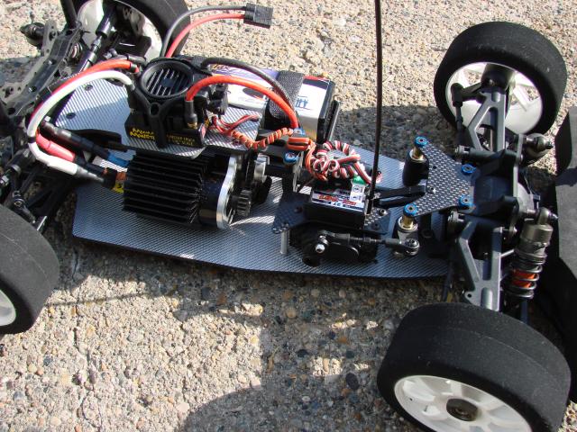

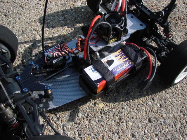

So I have finished my GTP SSG Graphite Chassis and ESC/Rear chassis brace.I decided not to use the side mudguards.I also widened the chassis on the motor side 6mm.This thing is a rocket,I did some speed runs and with the foam tires its alot easier to control at high speed.It has a Neu 1515.5y/s with mild settings on the MMM and 3s lipo..The fan only came on twice in 70f weather.

Purrrrrrty! I'd venture into some better lipos though, maybe some TP 40c packs?

That looks like a land rocket. Nice work on the carbon fiber.

Is your setup equivilant to the castle 2650 or the 2200? I plan on running the MMM 2200 on 16 and 21V geared at 20/51, metal spur of course. And I am looking for some black 4mm carbon fiber to cut my chassis. Your work has inspired me.
05.05.2009, 10:41 PM
His motor is 4400kv, and he runs it on 3s. That is equivelant to the 2200 on 6s.

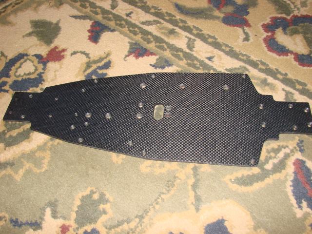

Forsale is this new unused 1/8 inch 15 layer carbonfiber chassis.Its symetrical and wider than the original.PM me for details.Thanks

How was that chassis cut?
