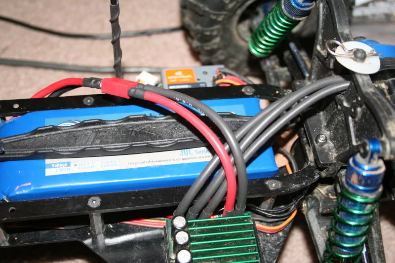

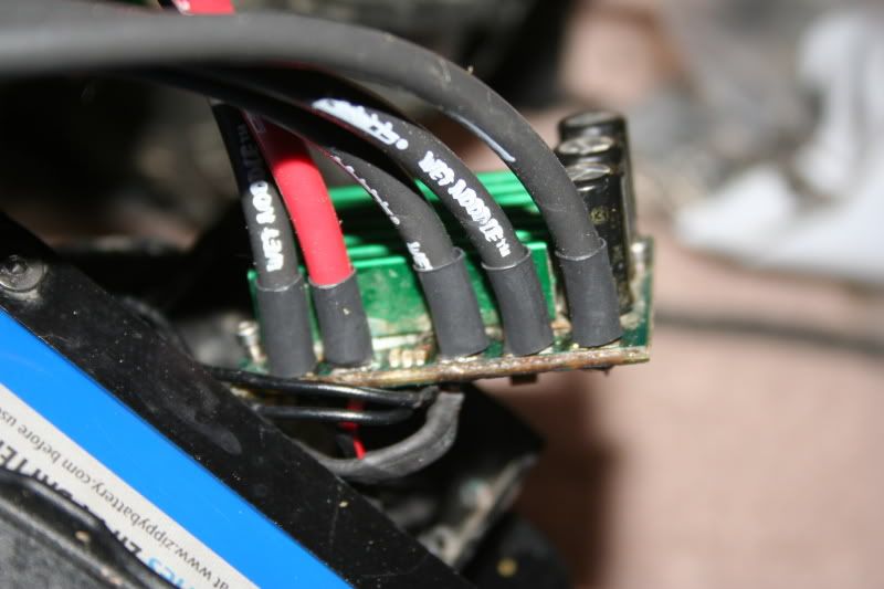

I just finished soldering on Deans Wet Noodle 12g wire on my mamba max esc. I did this because the original wires (13g) had torn insulation, heated up pretty good at the end of a run, I'm doing the black/blue theme, the warranty expired earlier this month, and just because I wanted to. I used just under 2 feet of black wire and about 5 inches of red. It definitely wasn't the easiest thing to do because the esc is a VERY good heat sink....this made in difficult to melt the solder. And yes, the esc still works.
IMO it looks pretty good if you ask me. ;)

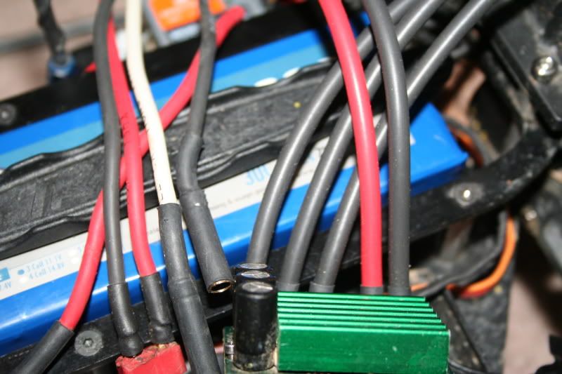

This is a comparison pic of the original 13g wire to the now 12g...BEEF lol.

You did a good job. Looks well done. Only thing I'd do different is the small BEC wires on the battery input, they look like you could have got them more "into" the solder. But if they are well connected, it shouldbe fine.

They are soldered on there very well, I didn't want to melt all of the solder holding the power wires in because they are hard to keep straight when the solder is melted.

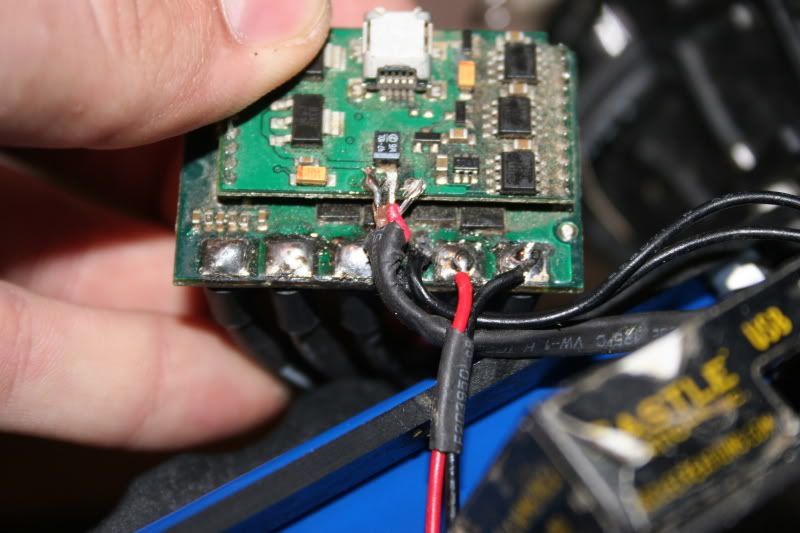

Nice job, my warranty expired too so i soldered a fan directly to the board so i dont have to connect it to the rx.(Brian is not gonna be happy about this )
