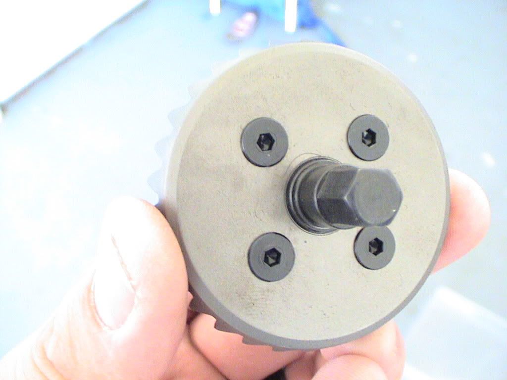

also, while i had the monster truck here i looked at the center diff. it is not a viscous diff. its just a locked spur gear so equal drive is sent to front and rear. i found a spur gear that i will think will work to replace the stock one. it has the right hole pattern and right size holes i just need to find out if the holes will match up.

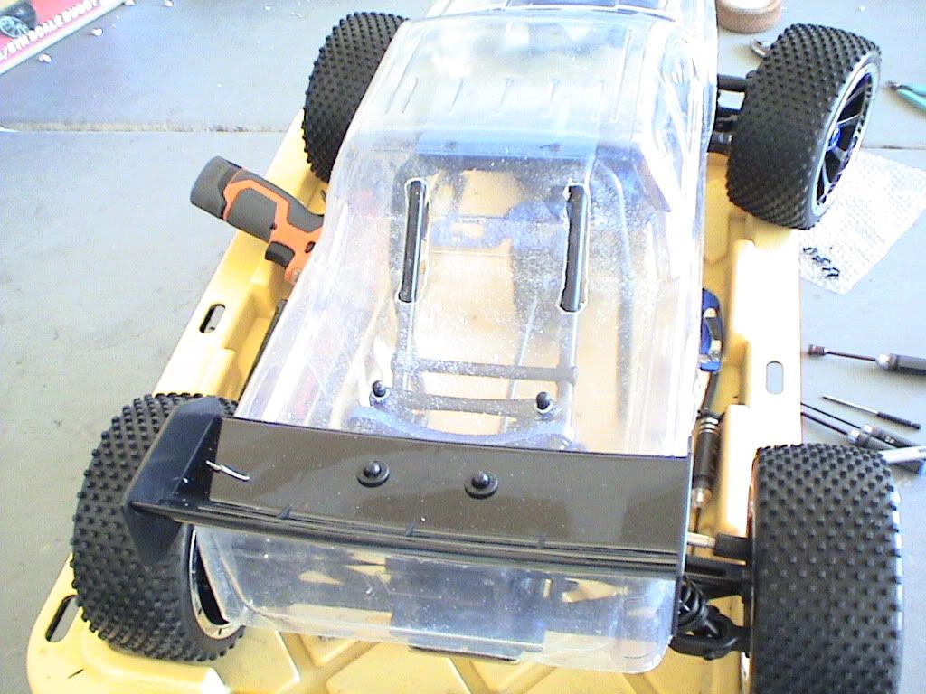

so the buggy finally arrived today and i immediately got to work.
i stripped of the clutch/drive unit, gas tank, etc.

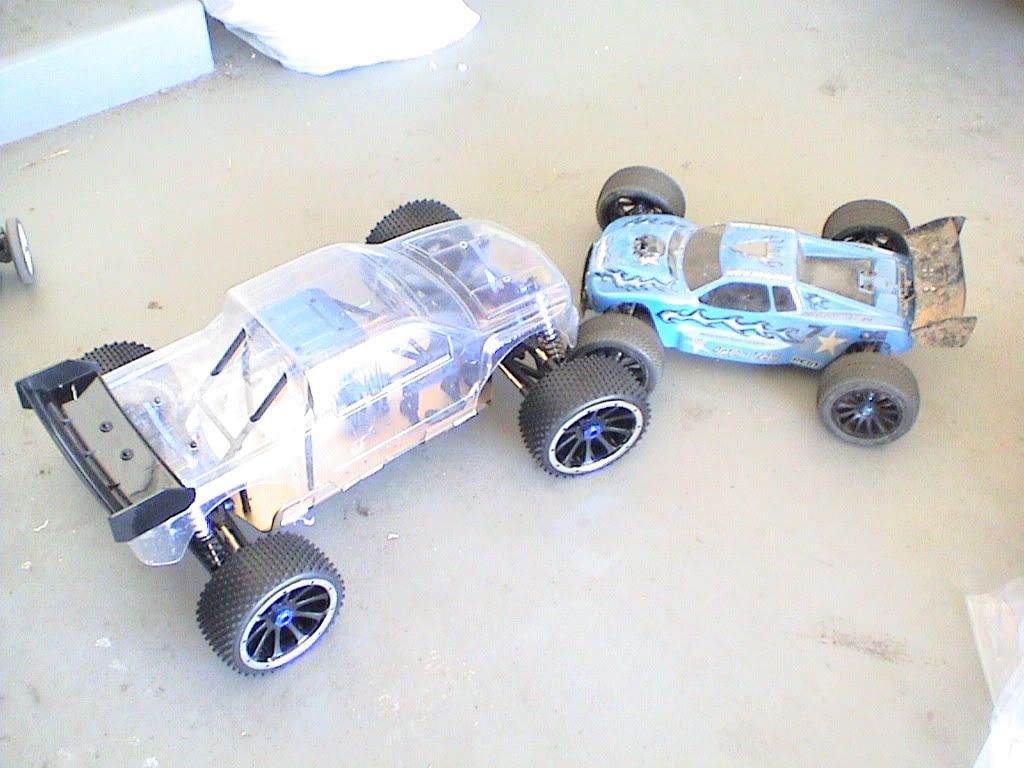

i have already modded the truck shell to fit so i now have a pretty cool looking truggy.

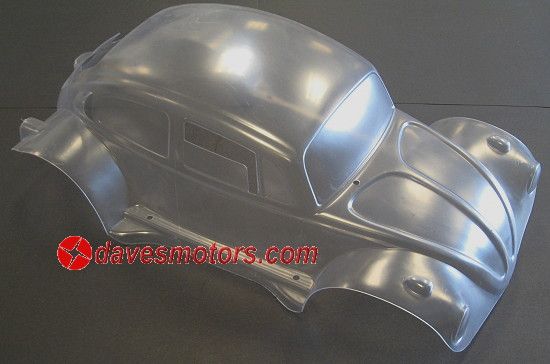

i have a FG Marder Beetle shell coming as another shell. i love those beetle shells.
fgbeetle

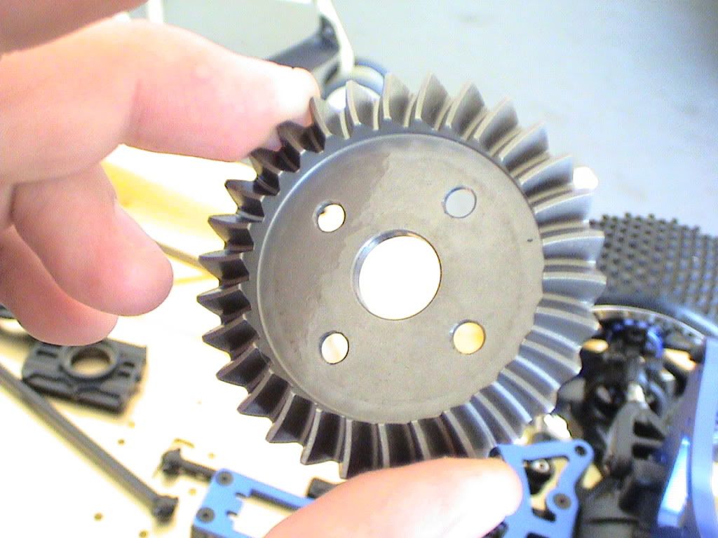

so here is what i figure: i think getting the servos and speed control mounted wont be to hard as there is plenty of room. i know where i want to put everything on the chassis, what type of motor mount i will use, and battery tray but the main challenge with this project is going to be the center diff/spur gear. so here are some pics and some of the things i have done, tried, and or about to try. any help that anyone can provide on this would be great. if i can just find a spur gear from another kit that will work that would be so much easier than having a custom gear made.

so here are the specs on the stock gear. the center hole is 12mm in dia. and the 4 outer holes are for m4 screws and are spaced 18mm apart. the diameter of the complete gear is 55mm and 31t.

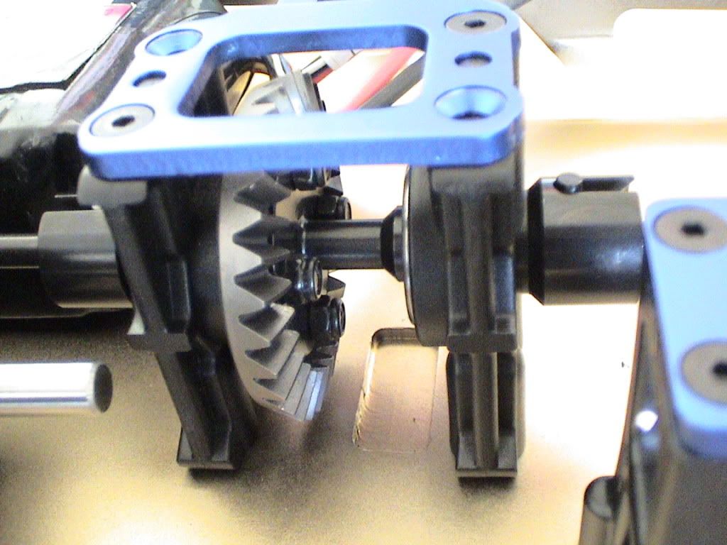

what i have done so far is flip the center diff unit around so that the motor shaft and pinion will reach the spur gear without hitting the center diff mount. i also flipped the center diff upside down as this allows the spur to sit higher off the chassis. i can flip it either way depending on what size spur i end up getting. i figure i will need a spur gear between 36t-42t which i think anything in that range will fit no problem.

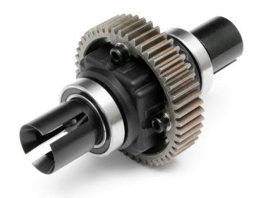

First, Smartech makes a center diff unit excatly like a 1/8. it has the brake pads on the outdrives and its an actual viscous, bevel gear diff unlike the locked redcat diff. so i might just get the complete smartech center diff setup and mod the chassis so that i can mount it up. still would need a spur gear but this might be the esiest way to run the mech brakes.

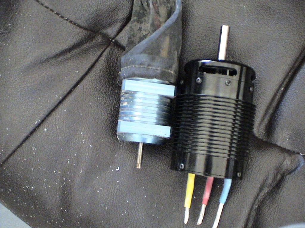

just a pic of the 2215 compared to a Tekno Nue 1515 1y.
and the 1/5 compared to my RC8T.

WOW that motor is huge!
