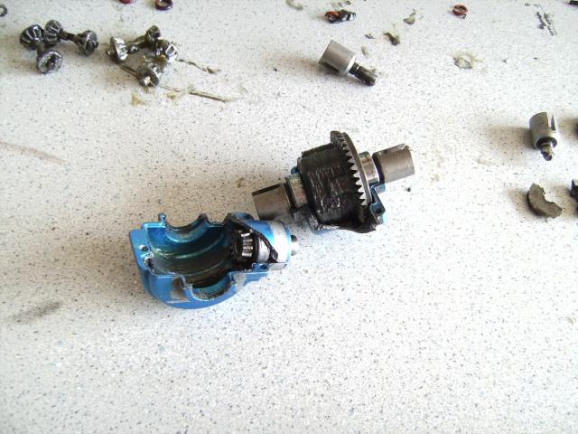

The pins are the same im pretty sure. HD cups would maybe help if you were breaking the spider gear pins, but the ones you're breaking its just the pin material.. Cut a piece of drill bit or allen wrench type tempered steel thats round lol ? Heavy truck landing with the throttle on, snap. Not insinuating anything (cough) but lay off the throttle when jumping, tiny "blips" for correction. I havent broken one of those diffs at that spot yet, could see how some stronger pins there would be nice.
