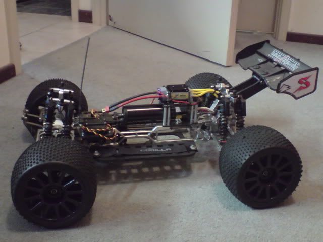

07.12.2009, 09:42 AM
Hey guys, its been awhile!!
@kcaz: the halfcase just went straight together with the tranny sorry about not selling it separately, i know alot of people are looking for a strobe setup in good condition, but i doubt i could have sold the tranny without a slipper.
So ive hooked the MGM back up, just for some fun, and took it out for a quick run the other day, not long enough for any video though . After a few passes the ESC was upto around 145 F, and thats when i stopped running. Both hthe motor and the batts stayed cool. I thought that the higher rated MGM would have run cooler than the MMM? Its geared for about 58mph at the moment, would gearing it more towards 45mph theoretically bring the temps down?
heres a quick pic, looks alot slicker with the mgm i think.
jordan

Rivermaxx
Posts: 638
07.12.2009, 11:47 AM
That truck is so awesome! Probably one of my favorite builds so far. Hey jordan what are you using for a body these days?

07.12.2009, 12:34 PM
For 5s lipo (it was 5s still?), gearing for about 40-45mph is plenty.
I would have thought the whole setup could manage alot more than that without getting hot, but... escs are funny things.
