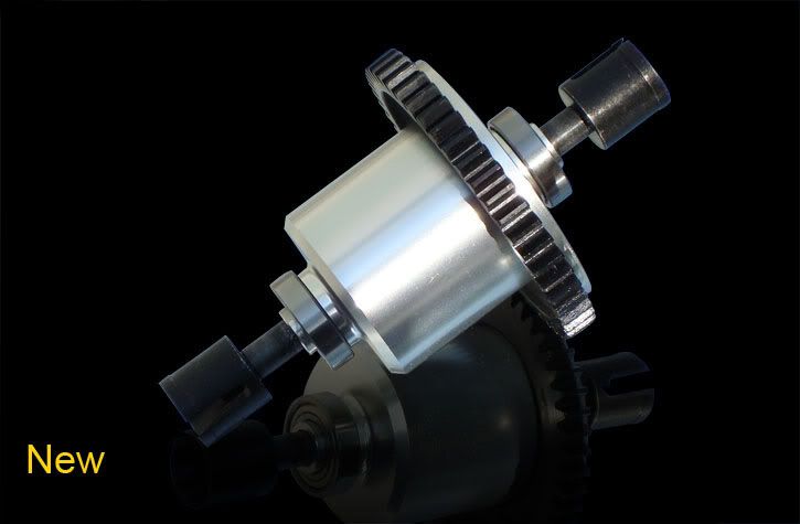

another thing i would like to do but not sure if i will is to get a 1/5 viscous diff like this that is normally used in the rear for a 2wd 1/5 but make a custom center diff mount and use it for the center diff. this unit is for the Nutech buggy.

How much is the NuTech diff?

I thought you were on the right track with the neutech setup, looks like a center diff in there too. If you're thinking about doing the rear diff from a 2wd 1/5 in the center, FG/Carson/Duratrax have a nice simple plate mount similar to a standard center setup I'd look into. The mounts are cheap, the FG diffs not so much, maybe the clones would be cheaper.
