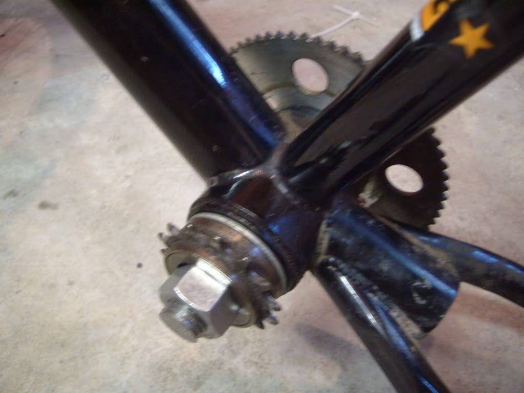

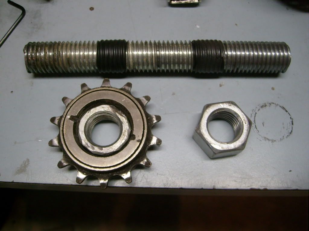

I got a 3/4" threaded shaft. My bearings require a 20mm shaft, so I made some redneck bushings.
To mount the freewheel, I took a grinder to a nut that fit and shaft so the nut fit inside the freewheel. I'll jb weld it in there later. The nut won't move because I'll tigten it against another nut.
Yes, the pic is blurry and the chain will be on the opposite side. I might put it back over on the other side if this doesn't work out. I just have to get that damn wheel.
