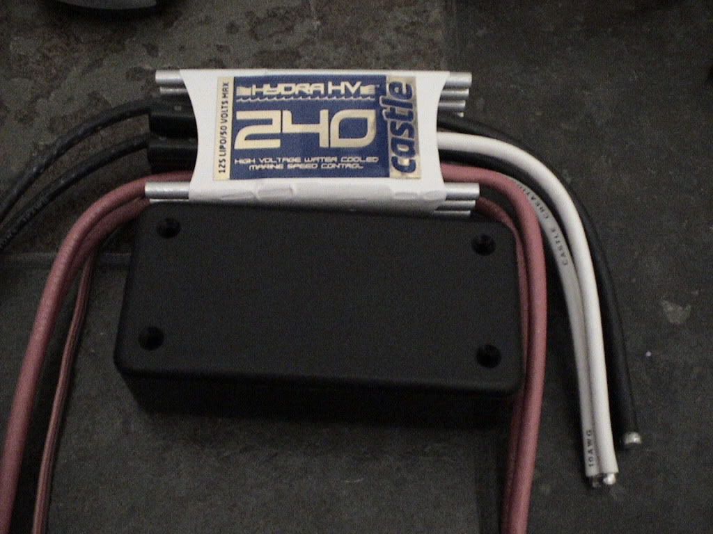

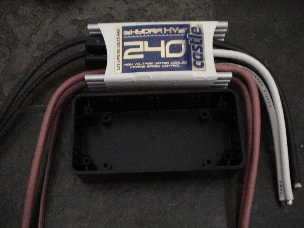

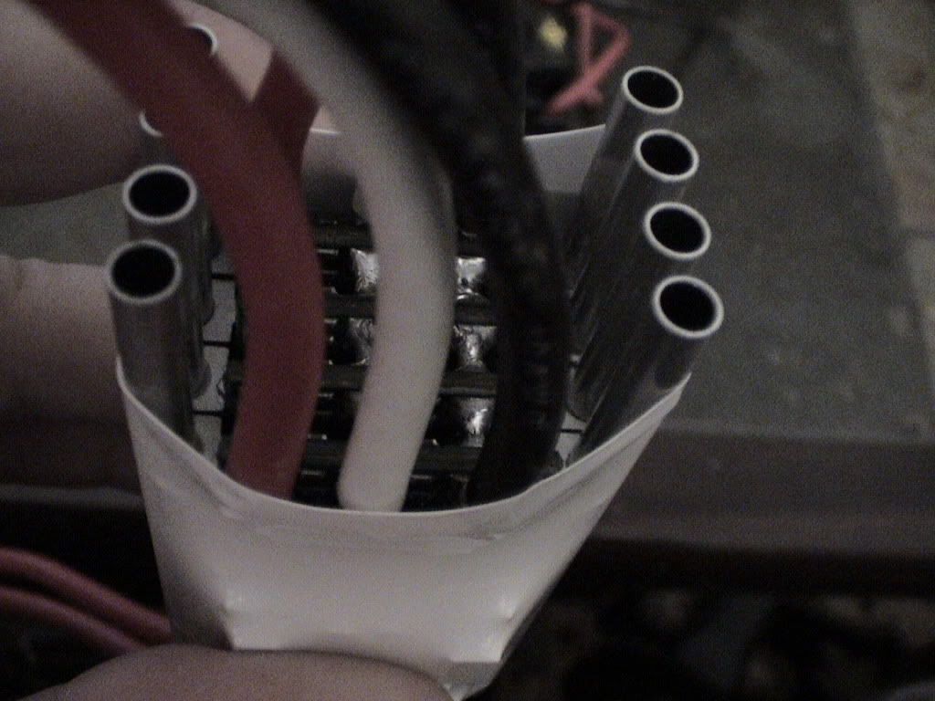

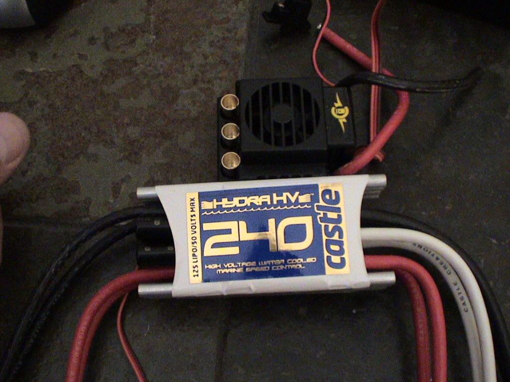

WOOHOO!! got my speed control today. here are some pics. i also found a little ABS box at radioshack that will work perfect to mount my esc and rx in. i will mod it so a fan will sit directly over the esc and hopefully that will be sufficient to keep it cool. it is normally cooled by water. i plant to make a new center top plate out of carbon that is large enough to mount the esc to.
been working on the swaybars. should finish that today and will post pics.

Thats a big speed controller!
As for cooling ideas.. maybe you can take off the water cooling plates and put heatsinks. Maybe take an aluminum box and fill it with mineral or silicone oil and submerge the esc 100% of the heat energy transfered away.
maybe just sync the esc to the chassis with thermal paste.
Because with the water cooling plates you just dont have the surface area of a heatsink to dissapate the heat energy...

Well the cooling plates are inbetween layers of boards sitting on top PLENTY of FET's. He would have to unsolder the layers to pull the cooling plates out.
I think it will be fine. I don't think your amp draw will be as much as the controller is rated for. SO i don't see it being a problem. The cooling plates are ALU as well so they will inturn act as heatsinks anyways.

thanks for the ideas. nitro is right. there are 4 alu. plates inbetween pc boards and the alum. plates are connected to alu. pipes extending in both directions which are normally used for water cooling. i thought about just removing the shrinkwrap so that a fan can put air around all the aluminum but i am not going to do any mods yet until i try it out. i dont want to void any warranty if i dont need to. Mike has said the the hv 180 has been working fine on the brushless baja he built so i am hoping this works out. if its running too hot then i will look at doing some mods to cool it down. i am thinking with one fan on each the motor and esc i will be able to use gearing to get both temps within the ideal range. i hope so anyway.

Hi Ryan, since you bought that box at radioshack, it includes a metal and plastic top, right? If you remove the water cooling bits, you can thermal epoxy the esc to the metal Case top, then epoxy a large heatsink to the other side of the top.
